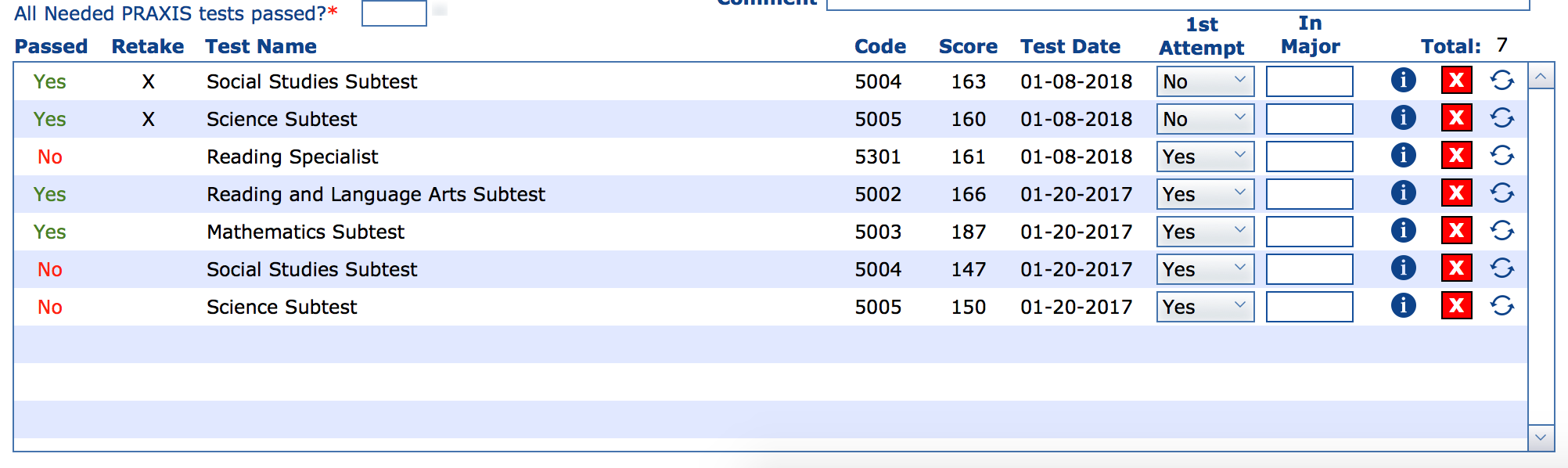

G'morning, all:
Please refer to the attachment. What I'd like to do is have the 1st Attempt (text) field auto-calculate whether a record's (Test) Code has been recorded with an earlier date; "No" if it has (e.g., there's an existing record for Code 5004 taken on Test Date 01-20-2017 so the record with it being taken on 01-08-2018 will have its 1st Attempt field set to "No"); "Yes" if it's the first time it's taken (e.g., Code 5002...and subsequent dates with Code 5002 would be set as "No".)
I know I could script this by sorting by Test Date then Code, then comparing the existing record with a previous one...which would then set the 1st Attempt to the appropriate Yes or No, but I'm curious whether I could set this up as a calculation within the child table...just that I don't know how to go about doing that.
Thanks in advance for your help!

Thanks, Siroos--I did what you suggested but ran into a snag--my fault for not adding this earlier. Because these calcs are done in the child table, the count for the number of times a code is used includes all the records with that Code instead of a specific student so I'm getting a count of 285 instead of say, 2, for Code 5005. To try to filter the count, I added the StudentID, in addition to the Code in the new TO (with an = sign, like Code), but that results in no records being seen, so that wasn't it.
