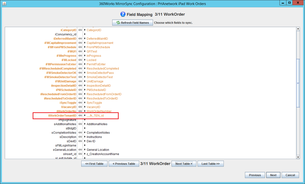

Attached is the configuration for the WorkOrder table.
Those fields shouldn't be orange... can you hover over one of them with your mouse and see if there is a tooltip message?
The tooltip says that the HUB field cannot accept nulls but the Spoke (FM) database does allow nulls.
However, all of these entries are supplied default values in the spoke table before syncing. If I'm not mistaken, any attempt to insert a record with null values in non-null columns prevents the record from being updated. The insert is taking place, but some of the values are not being updated.
OK, I would recommend setting those values in the spoke (FM) database to validate that they are not empty, that will at least stop MirrorSync from complaining about that.
