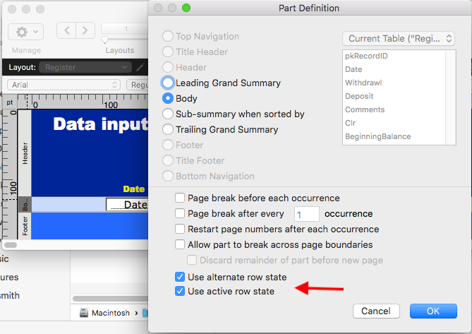

I did notice that the alternate state in the Part Definition was unchecked.
The "Use active row state" option is selected, the "Use alternate row state" is not. Does this mean the alternate state also has to be selected? By the way, the problem occurs on both my desktop and my laptop computers..
Here is your sample file back with the changes. Note that you need to give color for the Alternate records.
BYW, if you open the Contacts.fmp12 that came with your copy of FileMaker Pro, it also shows the list as I modified your file Example file.fmp12.
These are two different features.
Active row is showing the selected Record you are viewing,  Alternate Row is not a state, it is showing the current found set and separating them by shades of color.
