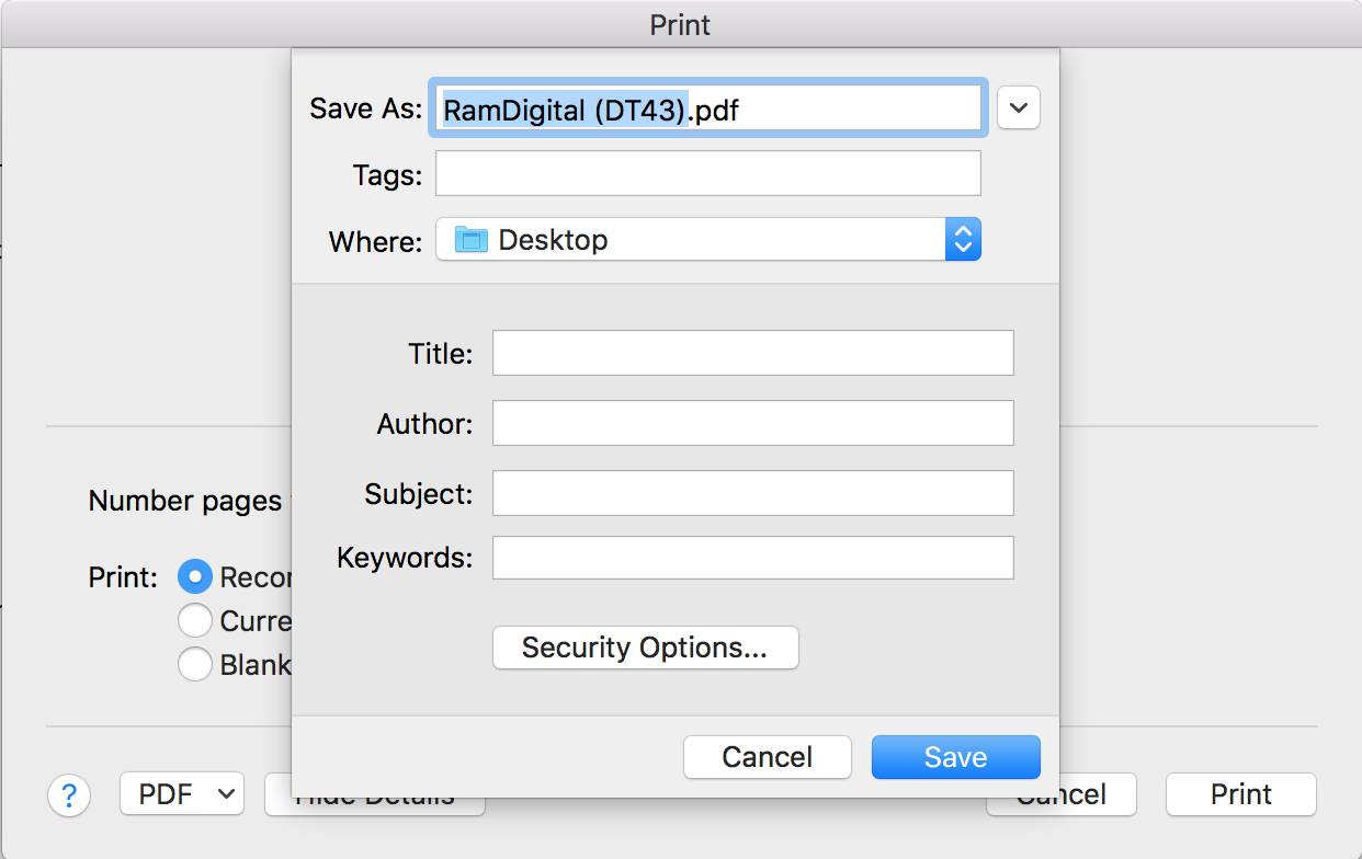

Hi, everytime we print and the print module pops ( Mac ) when get this pop up.
The only issue is, we have several soluiton in other companies and this "Ram" continues to show up regardless who we are hosting the file with.
Can anybody help me here with understanding ... and can were stop it, change it ???
Is there a way to default to someother name other than "RamDigital (DT43)pdf".  This was the 1st company we got and ever since then we have had no luck in finding a way to change the name or removing it.
Any suggestion would be gratefu.
Thank you.

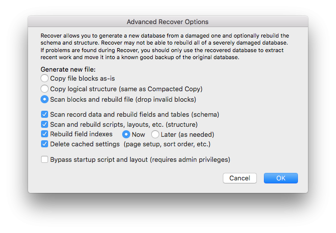

Possibly try to recover (notice last checked checkbox)

"Have you tried to recreate the script from scratch?"
Not from scratch ... the recovery did not do anything.  So I just replaced the two script steps; Print Set UP and Print,  within the print script and that fixed it.
So, thank you.
