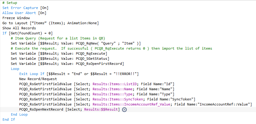

I have narrowed it down to Product Item ID not being pulling from QBO.  I can add products to QBO and get the Item ID, they appear in QBO but when I execute the script to pull all items down into FM the recently pushed item is not pulled down.  Script for Getting Items:
This does pull in items from QBO but as I mentioned the new item is not in the list.

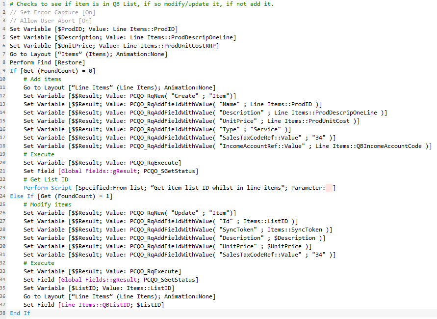

Here is the script to Add or Update Items:

I have constructed a script copying steps from the main database.
It first Pulls items down and places them into a table.
It then looks up the item to see if it's in the list.  In this case it is not in the list.  Therefore it adds the item to QBO and requests the ListID which it does get.
However, if I pull the list down again I cannot find the item I just pushed.  But I can find the item in QBO products 😕
When I run a QueryItem for the item it is not found.
So it doesn't seem to be finding the item when I run a query which explains why the rest of my scripting for uploading an invoice fails.  Here is the script I constructed for testing:

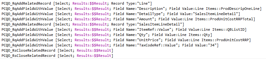

I have fixed the add/update Products script but I'm back to the original issue with the error when adding Invoices to QBO specifically SalesItemLineDetails Line:
Error executing request
CODE: 2010
SEVERITY: ValidationFault
MESSAGE: Request has invalid or unsupported property
Property Name:Unrecognized field "Line" (class com.intuit.schema.finance.v3.SalesItemLineDetail), not marked as ignorable (17 known properties: "ItemRef", "DiscountR specified is unsupported or invalid
SOURCE: PCQO_RqExecute
It seems to refer to the ItemRef value which as far as I can see is correct.  I have no idea why it mentions DiscountR as I'm not trying to apply discounts to the invoice.  The script is as follows:
PCQO_RqAddRelatedRecord [ Select: On; Results: $$Result; Record Type: "Line" ]
PCQO_RqAddFieldWithValue [ Select: On; Results: $$Result; Field Name: "Description"; Field Value: Line Items::ProdDescripOneLine ]
PCQO_RqAddFieldWithValue [ Select: On; Results: $$Result; Field Name: "DetailType"; Field Value: "SalesItemLineDetail"]
PCQO_RqAddFieldWithValue [ Select: On; Results: $$Result; Field Name: "Amount"; Field Value: Line Items:: ProdUnitCostRRPTotal ]
PCQO_RqAddRelatedRecord [ Select: On; Results: $$Result; Record Type: "SalesItemLineDetail" ]
PCQO_RqAddFieldWithValue [ Select: On; Results: $$Result; Field Name: "ItemRef::Value"; Field Value: Line Items::QBListID]
PCQO_RqAddFieldWithValue [ Select: On; Results: $$Result; Field Name: "Qty"; Field Value: Line Items::Qty ]
PCQO_RqAddFieldWithValue [ Select: On; Results: $$Result; Field Name: "UnitPrice"; Field Value: Line Items::ProdUnitCostRRP ]
PCQO_RqAddFieldWithValue [ Select: On; Results: $$Result; Field Name: "TaxCodeRef::Value"; Field Value: "34"]
PCQO_RsCloseRelatedRecord [ Select: On; Results: $$Result ]
Hello,
Value needs to be lowercase ItemRef::value.
Best Regards,
-Quincy
Ah, wonderful.  I spent hours on that XD
Many Thanks

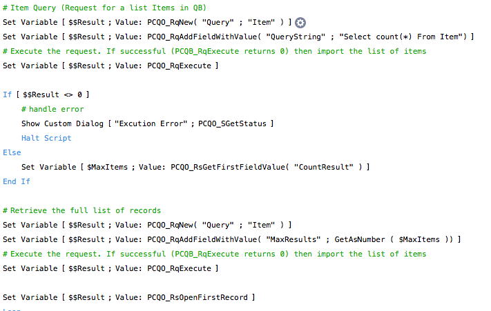

This information is for other developers like me dealing with the issue of an incomplete list, where it ends at 500 instead of the full list.
I used a query to determine the MaxItems and insert that in the query to retrieve the whole list
I used it successfully in the script for getting the items.
Hi Paul,
You are correct! There is, however, a cap that Intuit uses which natively sets the limit to 500 records, due to a limitation of bandwidth and throughput on the network connection. You can also use pagination to pull in all records from QuickBooks, by setting a combination of the "StartPosition" and "MaxResults" fields, and looping until there are no more records left to pull. We have an example of how to paginate in the Developer's Guide, for future reference.
Thanks!
- CT
