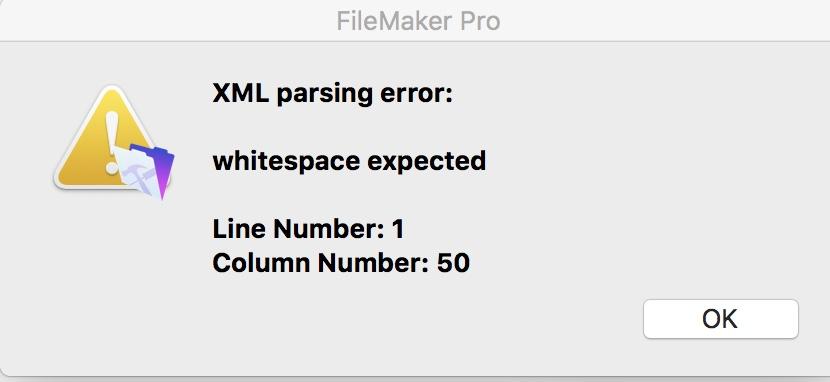

parsing error on XML import
The attached XML file works fine as a 'file' import. But when importing via http (using the same XSLT file), the import gets a parsing error. The xml file and the parsing error description are attached.
What's different when importing via http vs. a file import? Where/what is the expected 'white space' when doing the http import?

Again, when I use the 'file' option to import the file from my computer using this style sheet, I do not get the error. Only when, after uploading the same xml file to my web-site and using the 'http request' option in the import records script step, do I get the above error.

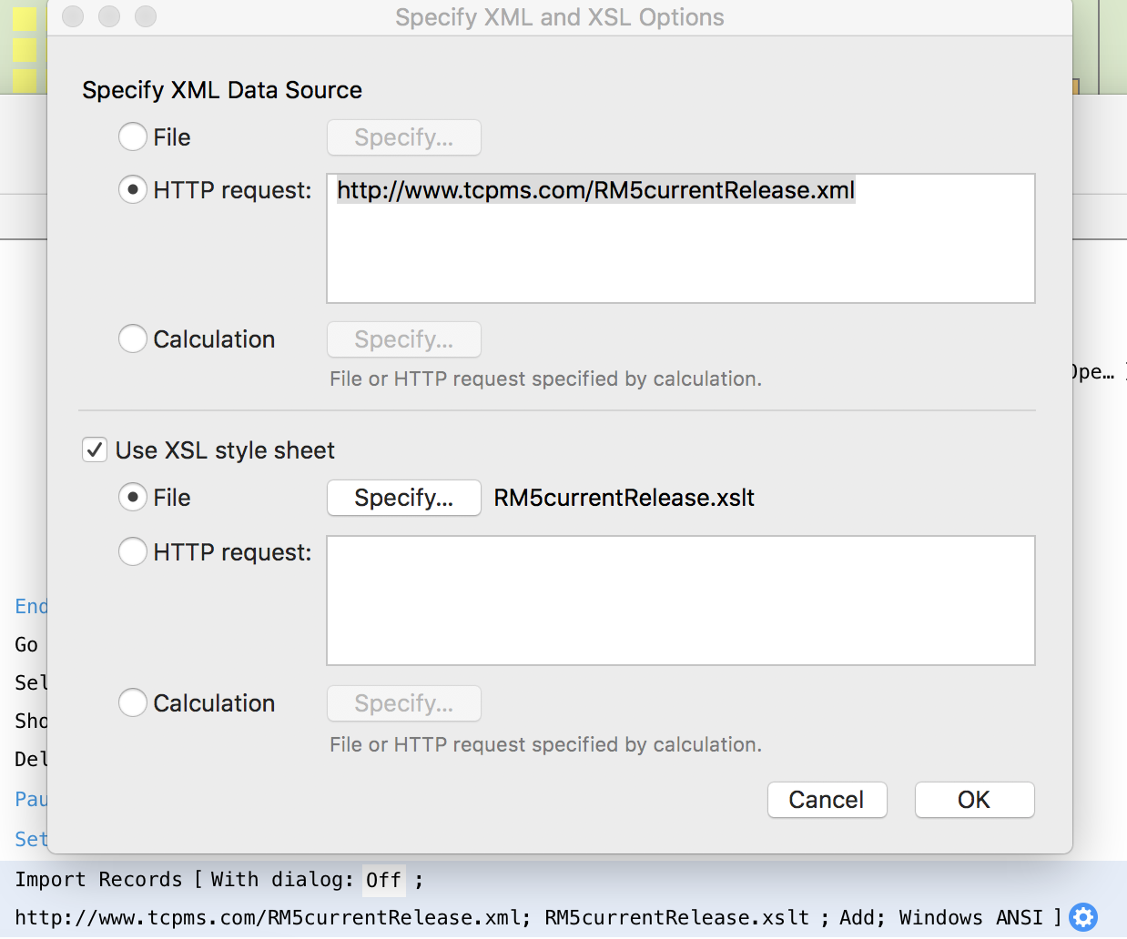

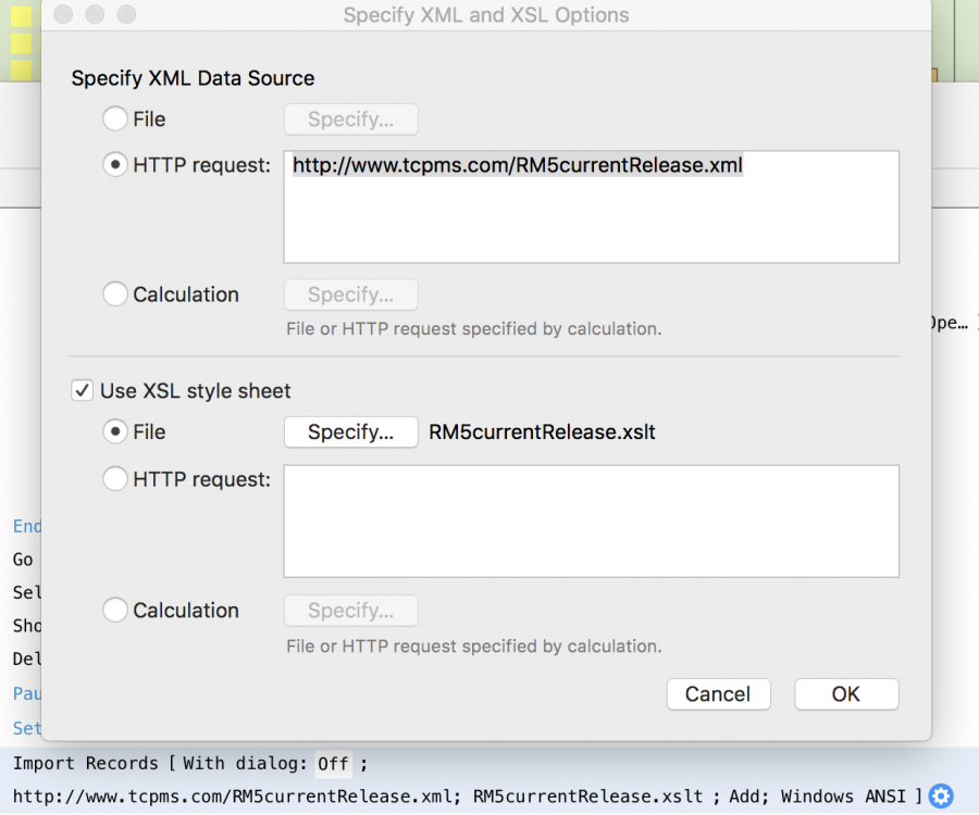

This is the 'http request' source that gives the 718 parsing error for the Import Records script step:
http://www.tcpms.com/RM5currentRelease.xml
Here's the import script step:
RM5currentRelease.xslt

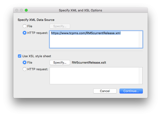

i have tried to reproduce the issue using the URL and the stylesheet provided in your latest post:
It imports perfectly fine, with no errors whatsoever. To be sure, I tried it again using version 15, as shown in your profile. Again, no problems. The problem must be elsewhere. Or it could be intermittent.

As I said, I imported (several times) from the web address you have provided, using the stylesheet you have provided (see my screenshot above showing both).
Since I cannot reproduce the problem, any speculation regarding the cause would be just that.
FWIW, I am attaching the files I used for testing - you can use them to eliminate your own files as the suspects.
