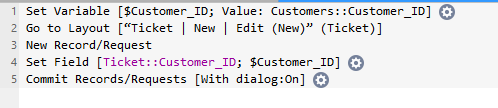

in my script I have the following steps;
This script runs via a button which I have on the portal row.
all the steps appear to be running except the "set variable" is not pickup the selected row but whichever record its active
Can someone give me an idea what I could be doing wrong.

You have a self-join relationship, which means you have (at least) two occurrences of the Customers table on the graph. In order to set the variable to the value that appears in the portal row, you must use the occurrence that is used to populate the portal.
Thanks. works like a charms
