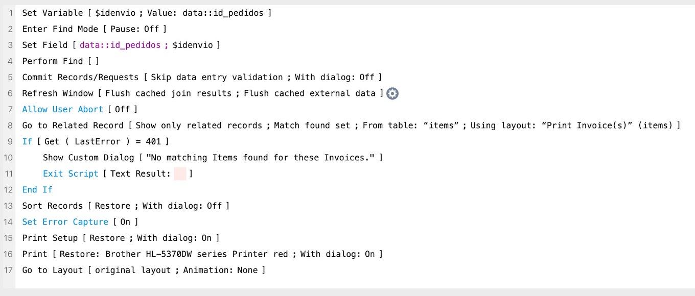

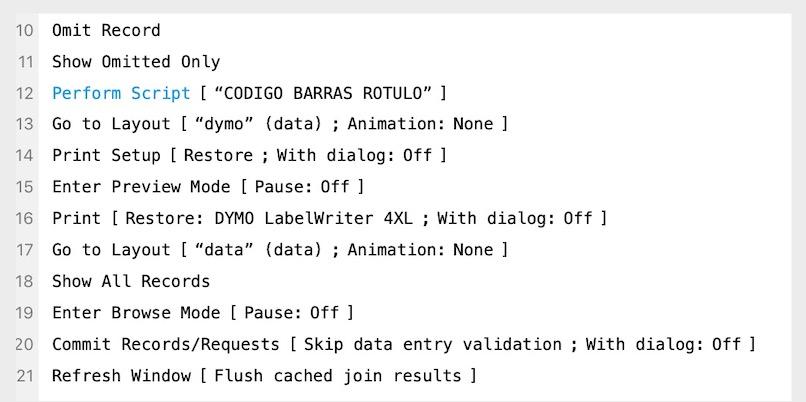

this is the script for the DYMO:
this is for the BROTHER:

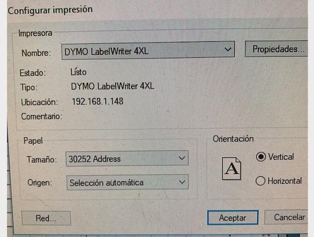

when I press the print button for the brother I got this:

Does changing the Print Setup script step to ... Print Setup [Restore ; With Dialog: Off] solve your problem?  I see 'Off' in the first script and 'On' in the second.  If the Print Setup in the Dymo script references the Dymo printer, and the Print Setup in the Brother references the Brother printer, you shouldn't have this problem.
However, you should have a  sub script for each type of printing, portrait, landscape, paper sizes, etc.  Then you could branch from a main print script with show custom dialog, or a card window.
With centralized sub-scripts called from a print script getting a new printer means a lot less scripts to find and change.
I usually leave Print Setup, dialog 'Off' in my scripts, because they usually don't change after initial set up, then leave dialog 'On' in Print step.
