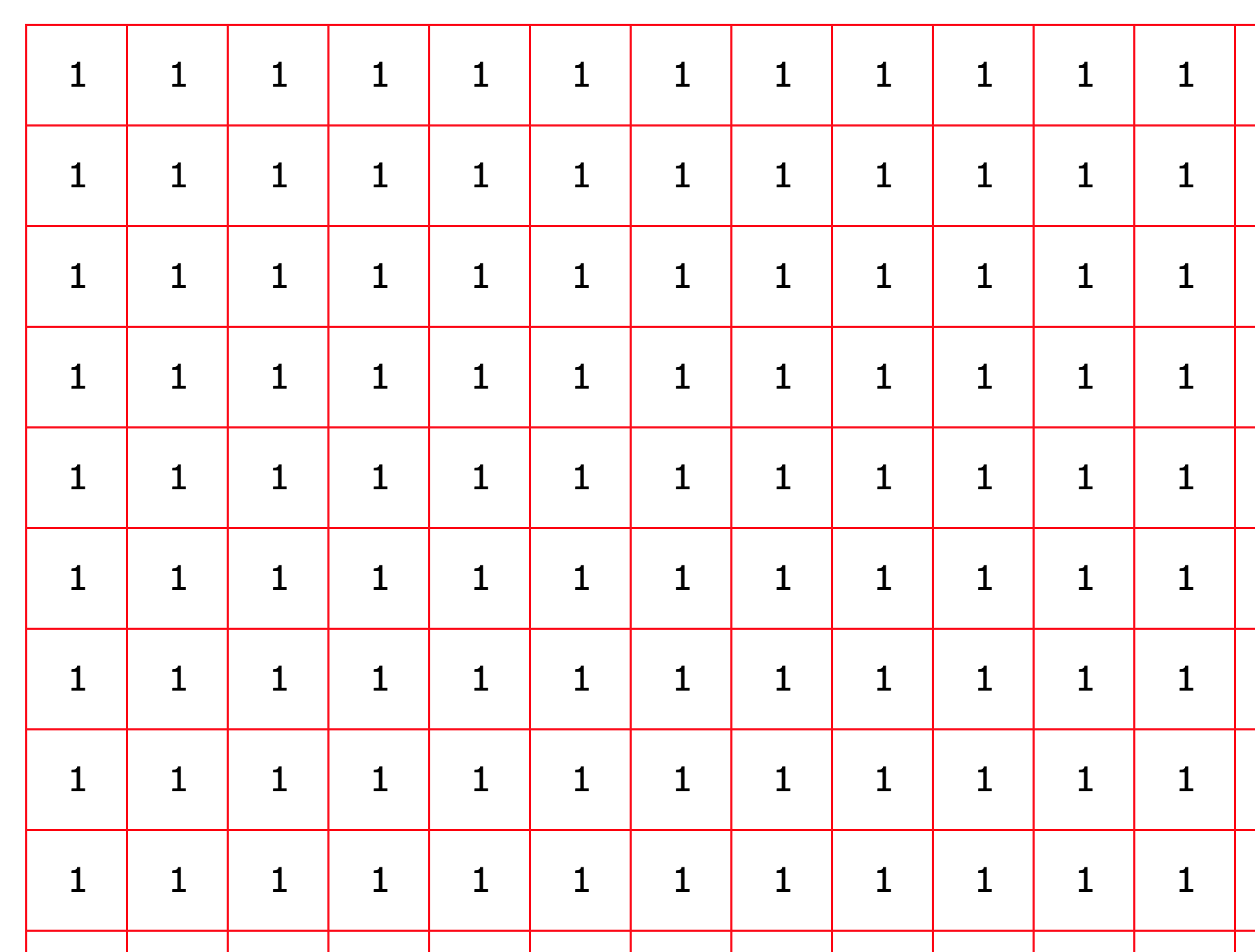

Hi,  I've loaded this script into FileMakers web view and the SVG is blurry when zoomed in ???
In an HTML, the SVG is script and clear.
Any suggestion I would be grateful.

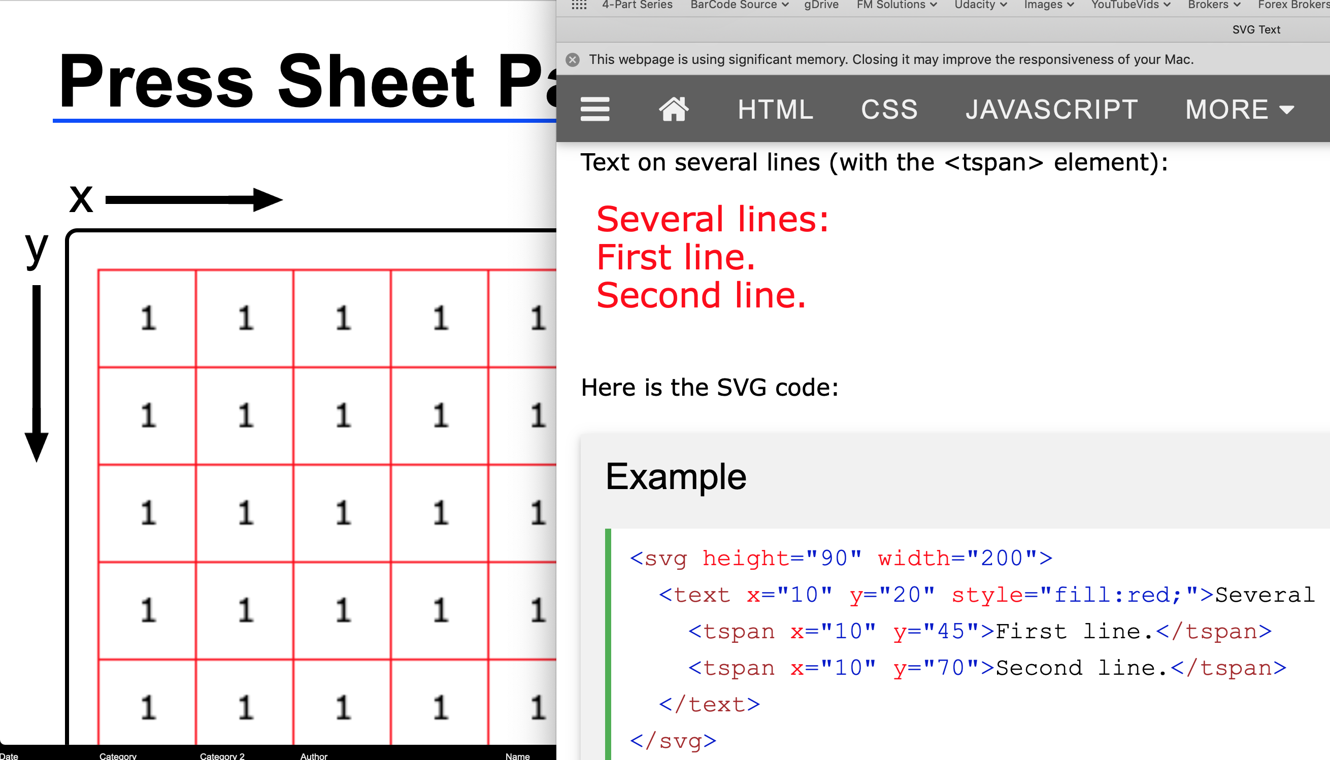

In FileMaker ... I zoom in, just like what the customer does .... zoom in, screenshot, print pic (customer )

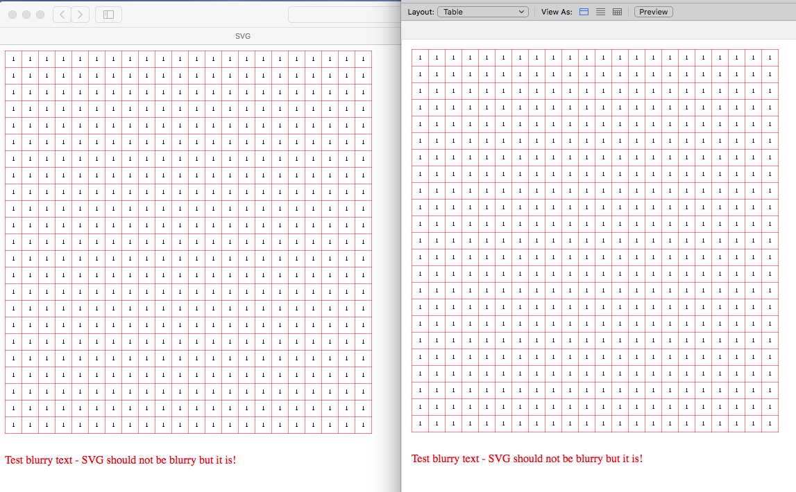

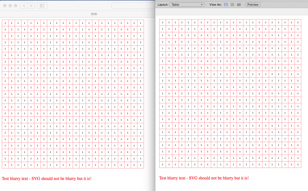

I've attached two window zoomed in at the same time.  FileMkaer w/webviewer and safari browser.
FileMaker never blurs, as well as the website (SVG tutorial ) yet when I use SVG inside FileMaker's webviewer you can see the red box and text are blurry ??
It is just frustrating .... everybody says to use SVG to avoid pixilation.  Yet when I take the time, figure it all out, use it, nothing changes.
So what is going here ?
FileMaker never blurs ?? yet inside the webviewer, the red svg line and the text blur ?? why ??

My experience is different from yours. Or maybe I don't understand what you're describing.
From what I see, when you zoom in on a Filemaker layout containing a web viewer, the contents of the web viewer become pixelated. This is regardless of what the web viewer is showing - IOW, this has nothing to do with SVG.
BTW, I can't say I am really surprised by this, because from the very little I know about it, matching the zoom level inside the web viewer to the rest of the layout would be quite a feat. As it is, the web viewer is just a foreign object tacked on to the layout.
That said, there's nothing stopping you from enabling the customer to zoom in on the SVG inside the web viewer.
