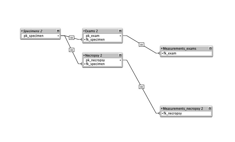

I'm working on a database for veterinary exams. During an exam, a set of measurements on an animal can be taken but not all possible measurements are recorded during each exam. Therefore, my current design has a parent table called 'Exams' and a child called 'Measurements' and they are related through the primary key of the 'Exams' table so that each measurement that is taken is recorded as a new record in the 'Measurements' table (with a label, e.g. 'right leg length', and a value, e.g. '50.5cm'). See attached screenshot of relationship graph.
During the actual exam, data are recorded on a paper form (please see attached photo for example of form). To streamline the data entry process, I would like to recreate this form in digital format within an 'Exams' layout, where all the possible measurements are shown within the digital form (just like the paper form) but where only the measurements that are filled in have a record created for them in the 'Measurements' table. This is where I'm a bit stuck, I'm not sure how to go about this as using a normal portal to the measurements table will not allow me to recreate the form with the same design as the paper form.
I've got a few ideas as to how to make this work, but they all seem a bit clunky and was hoping someone here had a better suggestion as to how to go about this? I think the easiest would be to create fields within the 'Exams' table for each possible measurement and removed the 'Measurements' table all together, but that will result in having a lot of empty fields and will make reporting more difficult (correct?), and there are a couple other procedures/table (e.g. 'Necropsy') where measurements are taken as well so I'd like to have a single table with all measurements in a single location. I could also create a helper table where the measurements are entered, and then a script creates the necessary records in the actual 'Measurements' table, but this seems it could be highly prone to error/problems and would result in duplicated data.

Thanks Comment! This is a very nice solution. It doesn't allow me to quite reconstruct the data entry form in the same layout as the paper form, but I think I should be able to get this to work. Appreciate the help!
