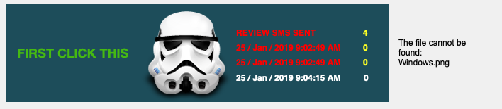

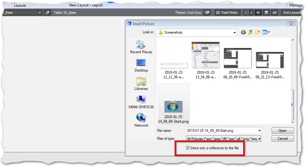

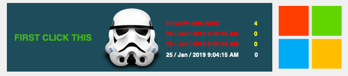

I inserted a sample .png on a layout  in my solution from desktop and assigned a script when I am deleting the graphic from desktop and the same graphic is getting disappeared on my layout why its happening ?????1013222231_Screenshot2019-01-25at09_04_54.png.e9522f0ba62f9eaeda162c09b8d08454.png238560046_Screenshot2019-01-25at09_05_18.png.18c25ccbf9b1edf4dc612571aeeadda3.png
Most likely you're using a reference to the picture, as opposed to a copy in FileMaker.

wow thanks for help neglected area
