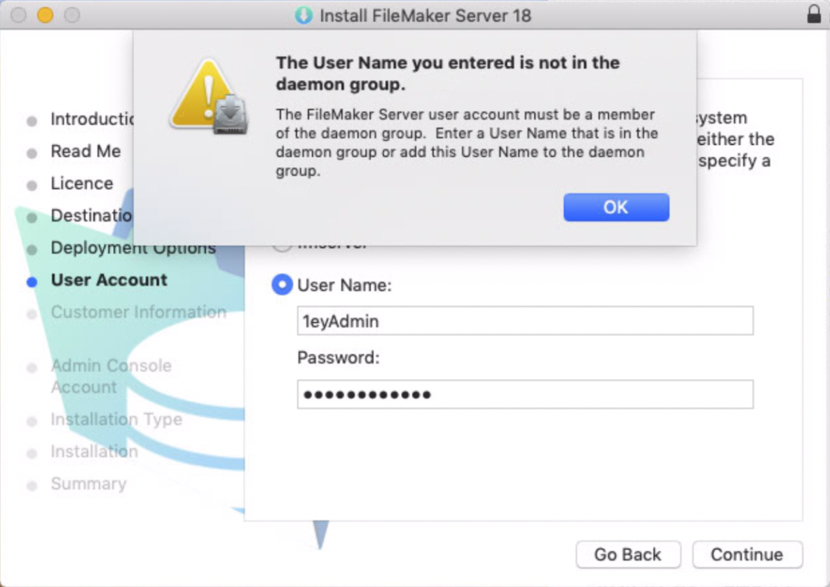

However, there might be another approach:  If you install FMS on an existing user account, it should work, you probably won’t need sudo.
The only problem is that this user needs to be in the daemon group and I don’t know how to do it.
I’ll post when I find a solution.

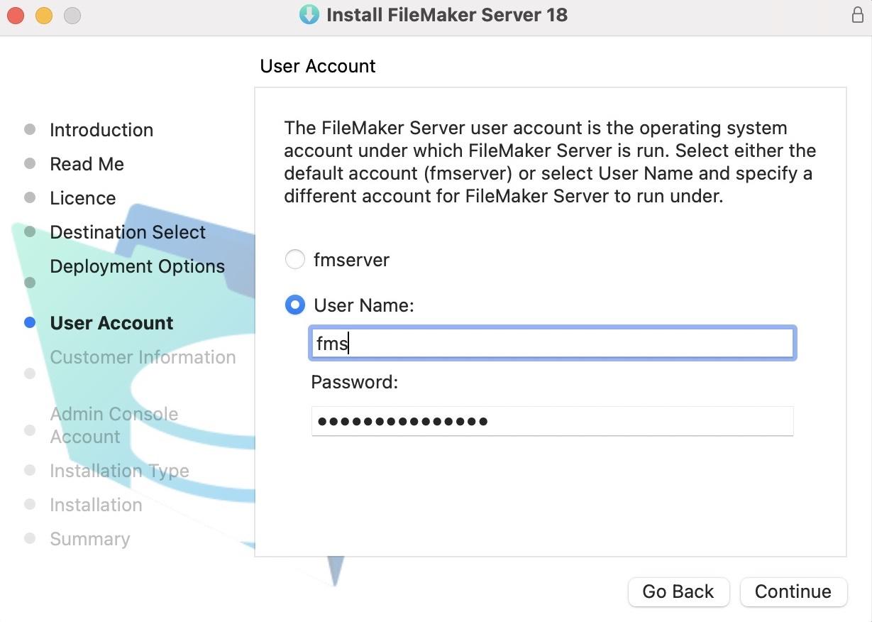

6) Now, give the new user a password using the Mac System Preferences (or System Settings, depending on your OS)
7) Finally, the FileMaker Server software can be installed. Use the newly created user for that.
8 ) In FileMaker server, install the necessary plugins.
Hope this helps
