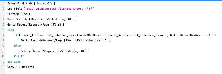

Here is my script ... (see attached screen shot)
39 minutes ago, kcep said:
I must have done something wrong.
Possibly - but I am not able to tell you what, based on your description.
Can you post your file, as it is before running the script?

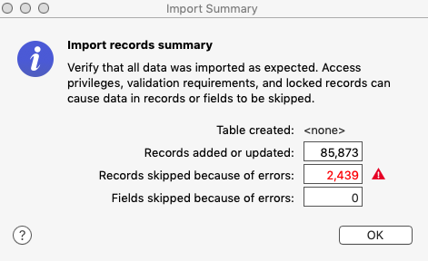

I tried the same things again ... This time my FileMaker database was on a local machine (instead of the company server), and everything seemed to work great. After the import completed, I received the following "Import Records Summary" notification (see attached screen shot). I'm pretty confident everything worked. My only concern is that the import skipped 2,439 records, and my original calculation with self-joining table showed that there were 1,802 duplicates. Do you think the difference could be the possibility that certain duplicates (2x) are actually triplicates (3x) or (4x), etc.?
Thanks!
I don't know how your "original calculation" works, so any opinion on that would be purely guessing.
If you still have a file with the original imported set, you can see how many unique values it contains by looking at the result of:
ExecuteSQL ( "SELECT COUNT (DISTINCT txt_filename_import) FROM Email_Archive" ; "" ; "" )
Note that the SQL result can be different from the result produced natively in Filemaker, since SQL is always case-sensitive while FM may consider "ABC" and "abc" to be duplicates (depending on the language selected to index the field). If you want SQL to ignore the case, you can modify the query to use LOWER(txt_filename_import)  instead of txt_filename_import.
P.S. I am still bothered by the fact that running the de-duping script did not reduce your total record count by the same number of 2,439 records.
