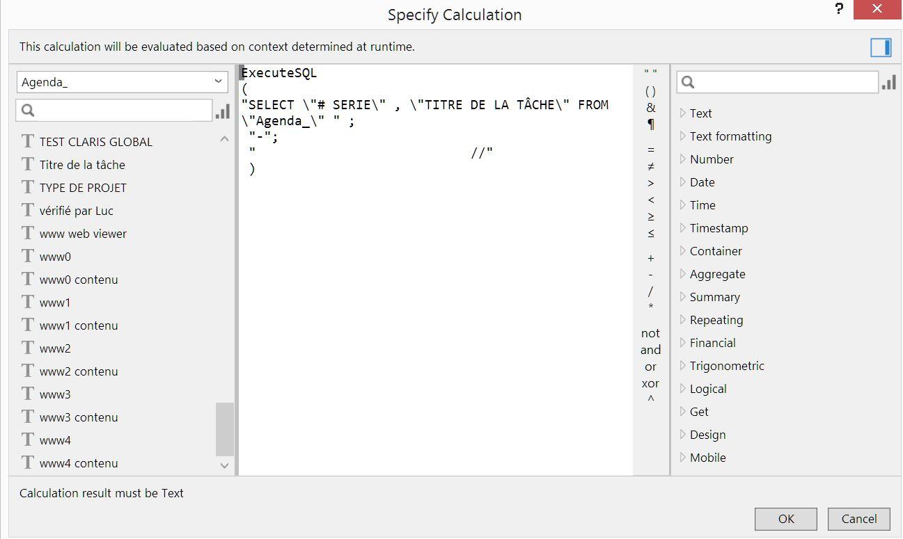

There is no way you can print data directly from multiple records on the same line. You need to collect the data into a single field in a single record. The simplest way to accomplish this, IMHO, would be to set a global field to the result of ExecuteSQL().
You're a genius. Thanks for your expertise.

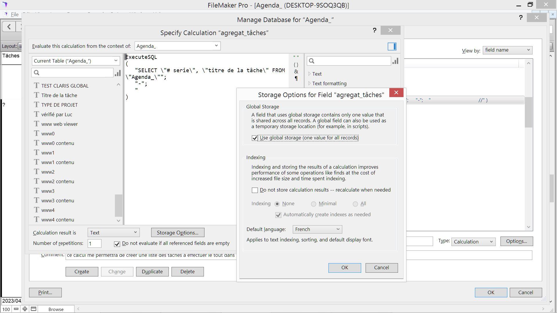

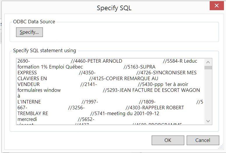

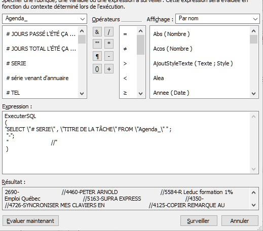

I tested it in viewers and when I put a value in both field separator and line separator it wraps it up exactly like I wanted. The only issue, although a major one, is when I place that field in a layout, I get a ? instead of the data I see in viewer.
Any suggestions on that ?
I would advise against using a calculation field here. Since you intend to print this, make it a script and have the script set the global field (of type Text) to the result of the SQL query. And you probably want to start the script by committing records - otherwise the SQL evaluation could take a while in a hosted situation.
If you must make it a calculation field, then it needs to be unstored - and therefore cannot be global.

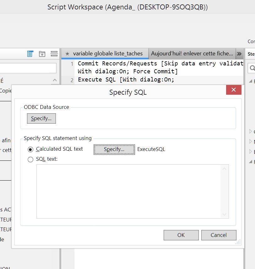

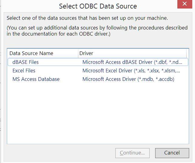

So I did integrate it in a script and it works but I do not know how to transfer the data to a global field. Sorry for noob questions I'm a bit rusted as I'm getting back to Filemaker after many years of not touching it much. If you still have time and patience, could you point me again in the right direction ? I must say I see a lot of potential with the ExecuteSQL command which I never used before.
It can be a bit confusing, but the Execute SQL script step has nothing to with this. All you need to do is use the Set Field script step to set the global field to a result calculated using the ExecuteSQL() function (using the same formula as you did in Data Viewer). Note that the script step has a space in its name, while the function's name is a single word.

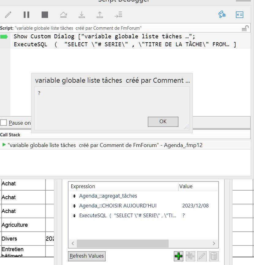

So on 16 pro adv. run locally, your file runs fine. However, when I import your script into my hosted Agenda_, it gives me an ? on data viewer as you can see :

2 hours ago, curious99 said:
if you think that the 'server" running 15 pro could be the culprit
I doubt that. I suspect there is a difference between the files. Are you sure the file you posted is a trimmed copy of the actual file? I have a feeling it is not - which would defeat the entire purpose of making it.
But you will know for sure when you try unhosting your file (or hosting mine).
