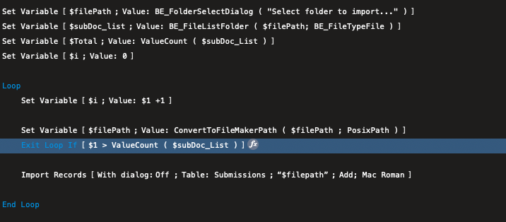

March 7, 20242 yr Author Ok I have the correct server path now, however it's still not working. When I run the script debugger, it's Exiting the loop before it even gets to the Import Records step. This is what I have, does anything look amiss to you ?

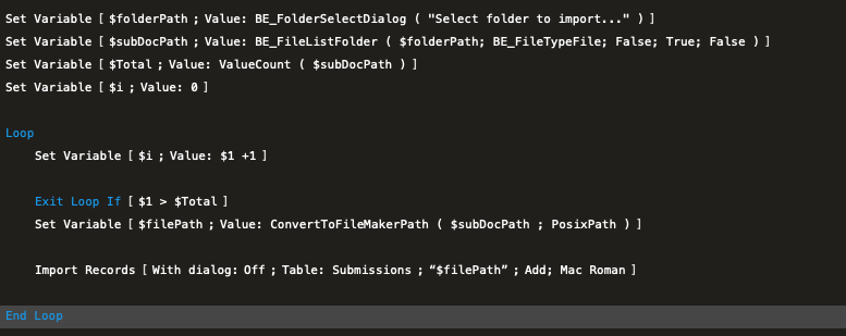

March 7, 20242 yr Author the path is to a folder on our server, that contains multiple .csv files. Oh I may have missed a step. I don't have a list of files. Where in the script would I add that? I've attached the screenshot of my script so far... thank you !

March 7, 20242 yr Author When you said you couldn't see the entire picture, I thought you were referring to the attached picture, hence I attached again. Last year I was trying to import multiple FMP files, but now I'd like to import .csv or .xlsx. I'm going to concentrate on .csv for now as they are the files we currently need to import. Path to the folder containing the files to import looks like this: /Volumes/BH_VFX/files_to_import/ I'm using Base Element now as you suggested, so my new script looks like the below. Unfortunately it's getting stuck, at the actual Import Records stage. It seems to completely skip that stage. Also in your script example above, you use $filepath & $filepaths, is that intentional?
March 7, 20242 yr The BE_FileListFolder() function can return either a list of file names or a list of full file paths. The default (which is what you are using now) is file names only. So you need to either prepend the folder path to each file name in the returned list, or switch the function to return a list of paths. I would suggest you try the latter first. Then your script could be like this (again, untested): Set Variable [ $folderPath; BE_FolderSelectDialog ("Select folder ..." ) ] Set Variable [ $filePaths; BE_FileListFolder ( $folderPath; BE_FileTypeFile; False; True; False)] At this point, the $filePaths variable should contain a return-separated list of full POSIX paths to the files in the selected folder. You can test this by inserting a step: Show Custom Dialog ( $filePaths ) which should display a list like: /Volumes/BH_VFX/files_to_import/abcde.csv /Volumes/BH_VFX/files_to_import/fghij.csv /Volumes/BH_VFX/files_to_import/klmno.csv ... Now your script can continue with: Loop Set Variable [ $i; $i + 1 ] Exit Loop If [ $i > ValueCount ( $filepaths ) ] Set Variable [ $filepath; ConvertToFileMakerPath ( GetValue ( $filepaths ; $i ) ; PosixPath ) ] Import Records [ “$filepath” ] End Loop (Of course, you need to set up the Import Records[] step so that the correct data is routed to the correct fields in the correct table.) 37 minutes ago, Smidge500 said: in your script example above, you use $filepath & $filepaths, is that intentional? Definitely yes. You can use your own names, if you find it confusing.

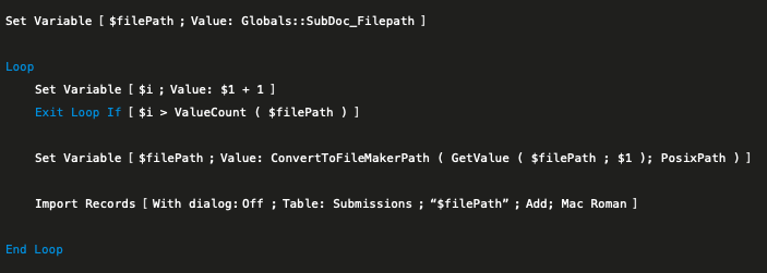

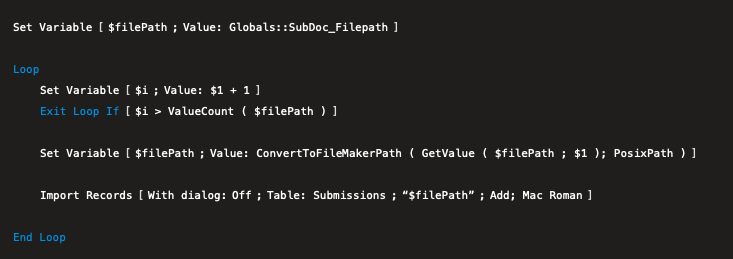

March 8, 20242 yr Author Great thank you ! Most of the steps are running now. My only issue is the loop won't move to the next iteration. It keeps importing the first .csv over and over and again. I also couldn't get the ConverToFileMakerPath working with the GetValue addition, so I removed that and it works.
March 8, 20242 yr 49 minutes ago, Smidge500 said: is the loop won't move to the next iteration Well surely it does, if it keeps doing [anything] over and over ... It just won't move on to the next file because you are not telling it to pick the next value from the variable containing the file paths. That's what the expression: GetValue ( $filepaths ; $i ) does in my code. 55 minutes ago, Smidge500 said: I also couldn't get the ConverToFileMakerPath working That's not a useful description. You should say what happened when you tried it. Use the Script Debugger and Data Viewer to establish exactly what is happening. Or at least my poor man's version using Show Custom Dialog. 1 hour ago, Smidge500 said: so I removed that and it works. Except it doesn't.
March 11, 20242 yr Author I realised I had a typo in there, so all working now. Thanks for your help!
