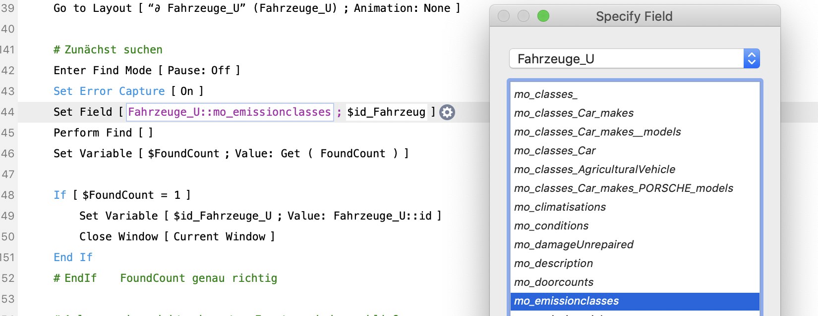

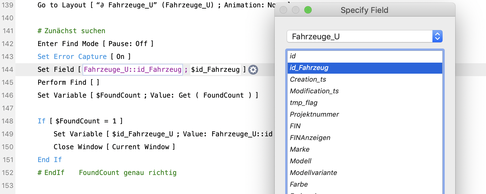

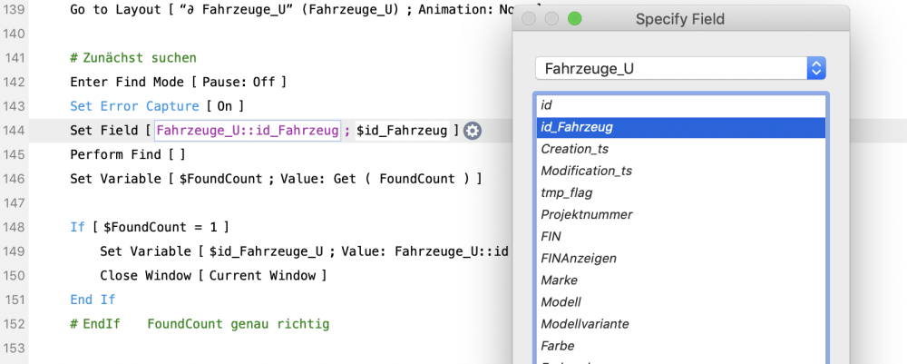

But all scripts with field references to the remote database are screwed up! Where once were the correct Set Field statements, for example «Fahrzeuge_U::id_Fahrzeug» is now «Fahrzeuge_U::mo_emissionclasses», a totally arbitrary field reference. I couldn’t check all >1000 occurences in all scripts, but from a first glance only the field references are bad, not the table references. See screen shots.

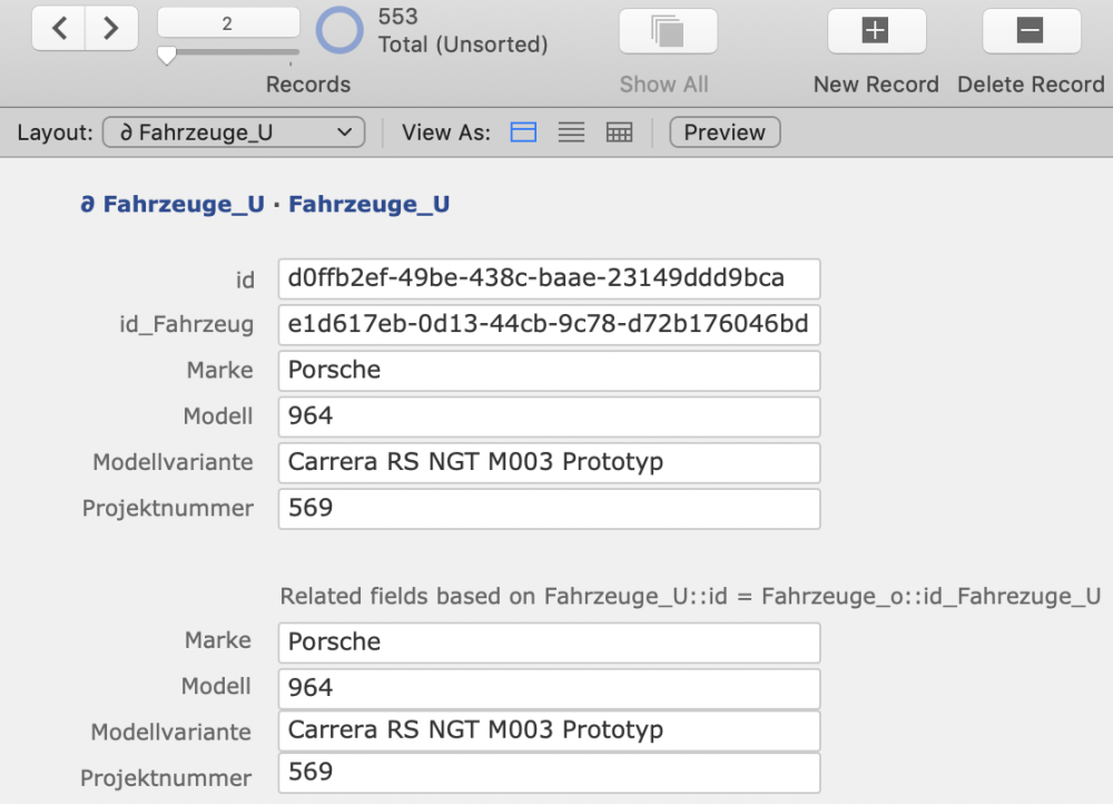

When I switch back to the old data source (changing the table occurences back to the original table), everything is back to normal. All field references in all scripts are reverted back to its original correct value.

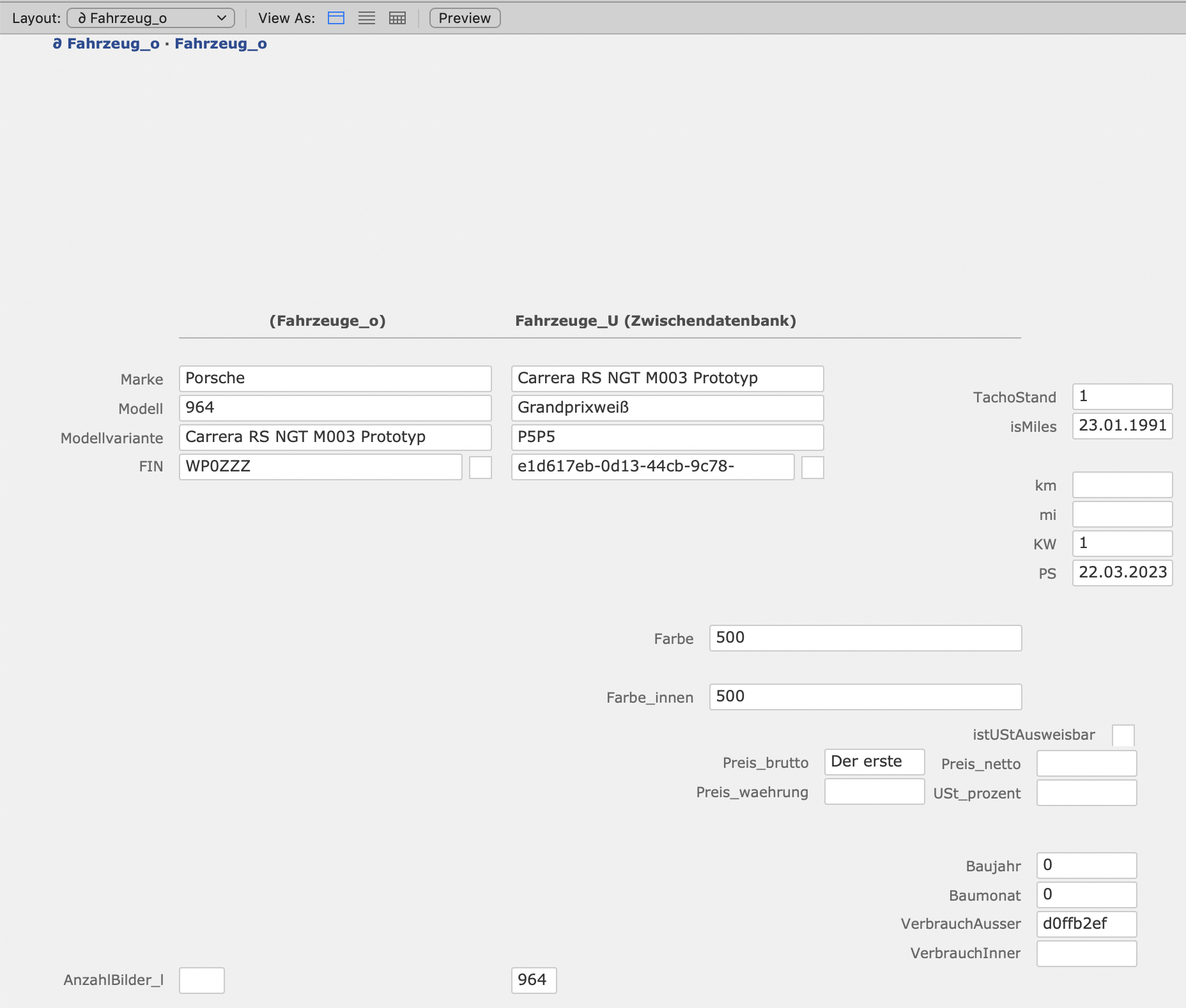

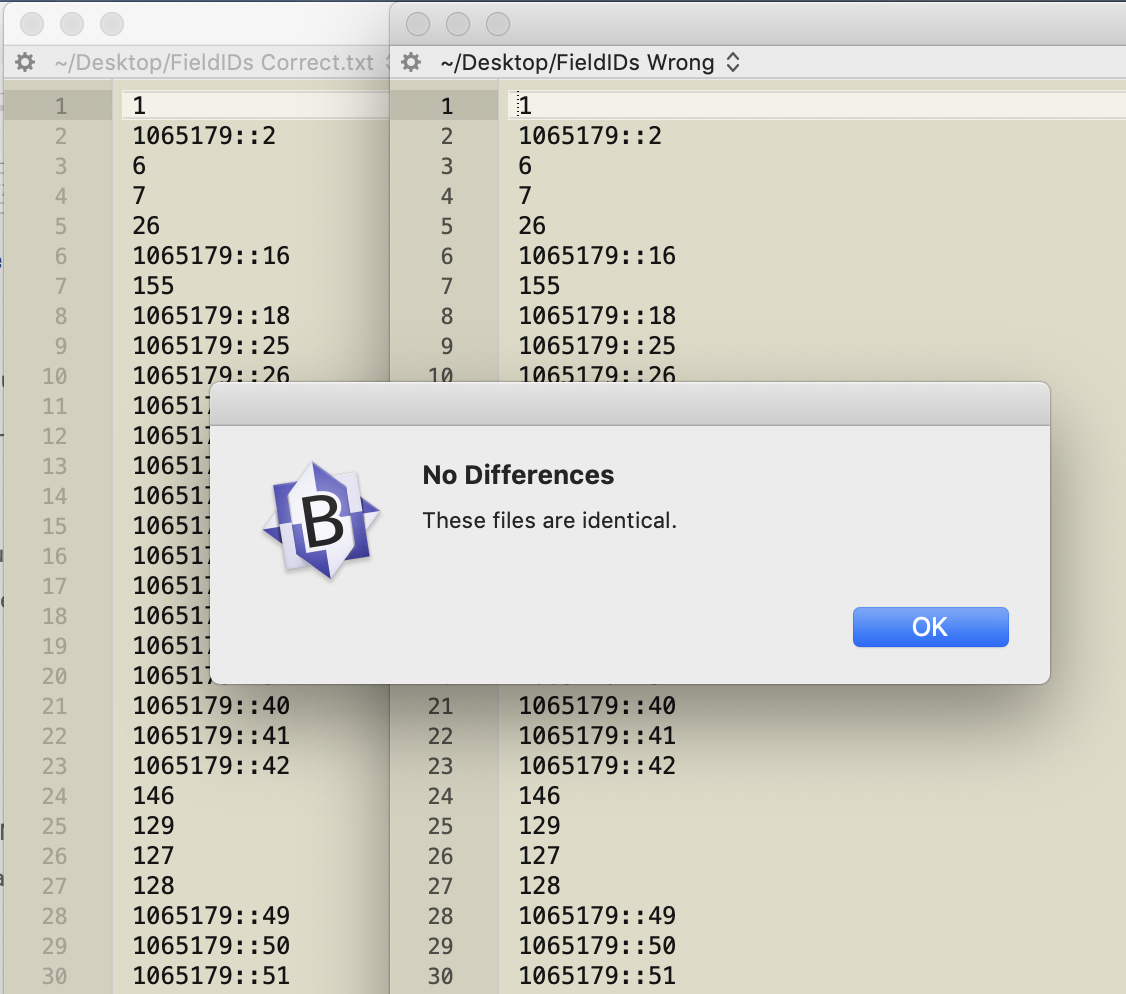

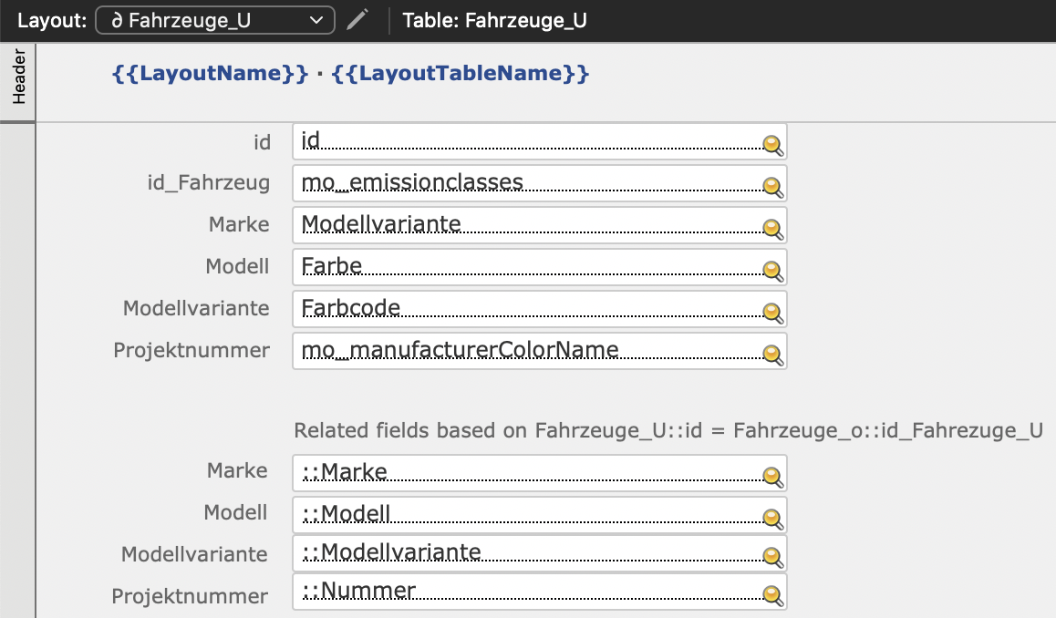

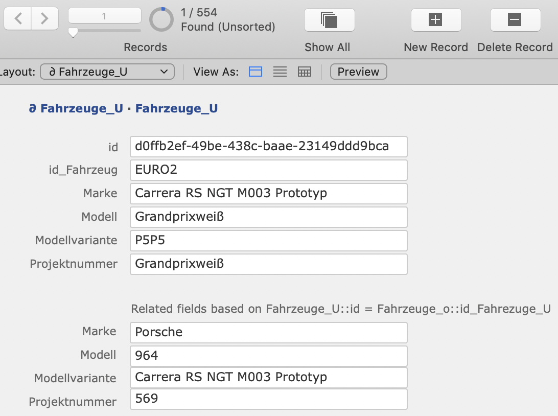

I checked one Layout using the external data source and then switched the data sources. This is what I got:
• FieldIDs are identical
• All related fields on the layout are mixed up
(see pictures)
So, it's not only the scripts but also all related fields on all layouts  :-(

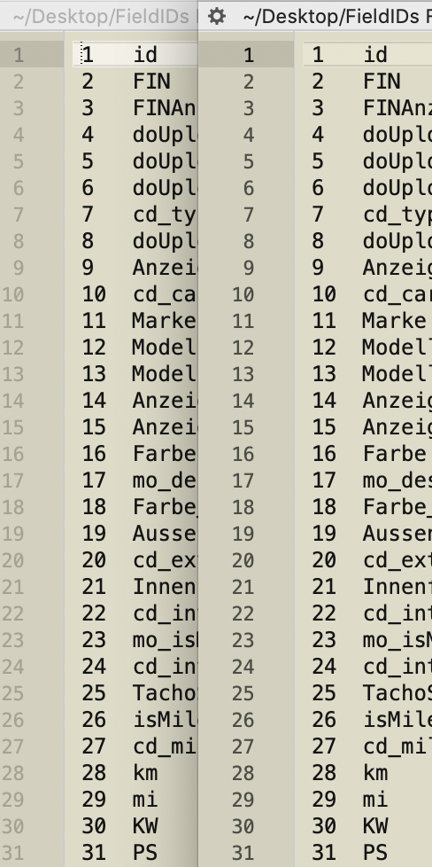

Interestingly enough, FileMaker’s IDs and field names are also identical on both data sources. I checked this with:
    SELECT FieldID, FieldName
    FROM FileMaker_Fields
    WHERE TableName = 'Fahrzeuge_U'
    ORDER BY FieldID
Edited by gczychi

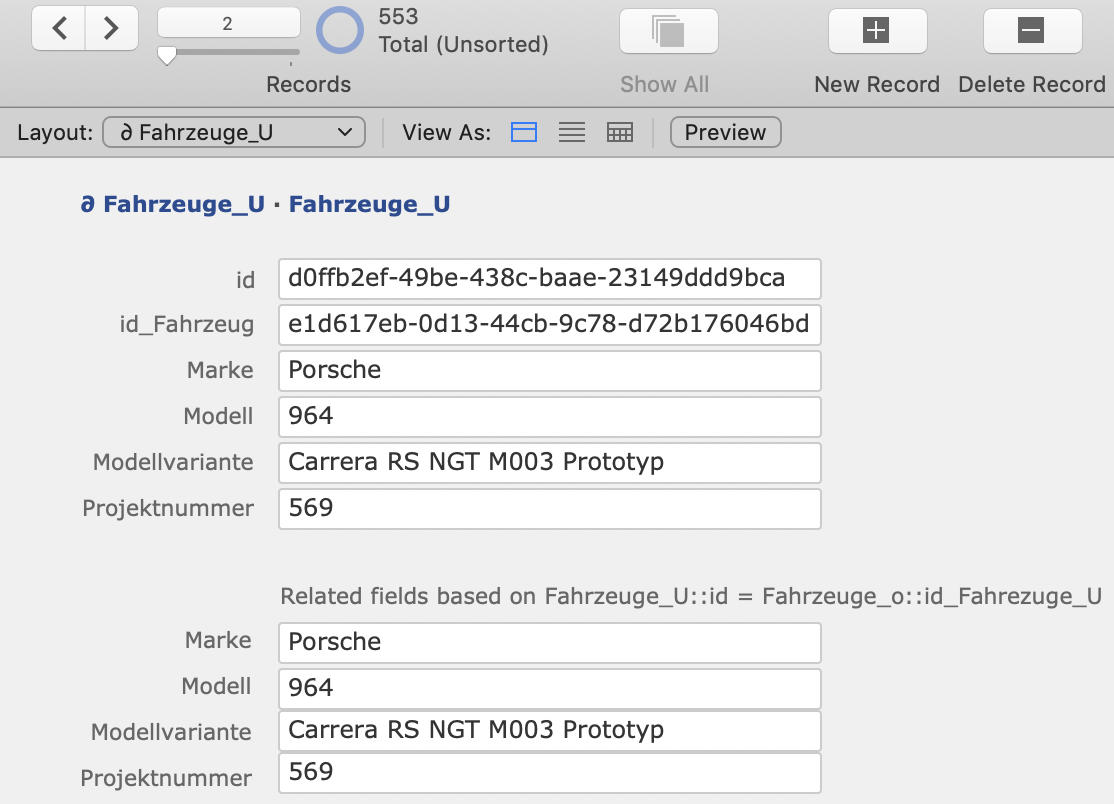

I am not sure what you mean by "related fields". I am even less sure what your test is supposed to prove.
I would create a layout of the Fahrzeuge_U table, and place only the id_Fahrzeug field on it (while you're connected to the old source). Then switch over to the new source. If the field placed on the layout is now mo_emissionclasses (check this in Layout mode), then my hypothesis is very likely correct.
Unfortunately I have no idea how you can fix this (other than changing each individual reference manually).
Yes, you’re right. It is exactly as you predicted.

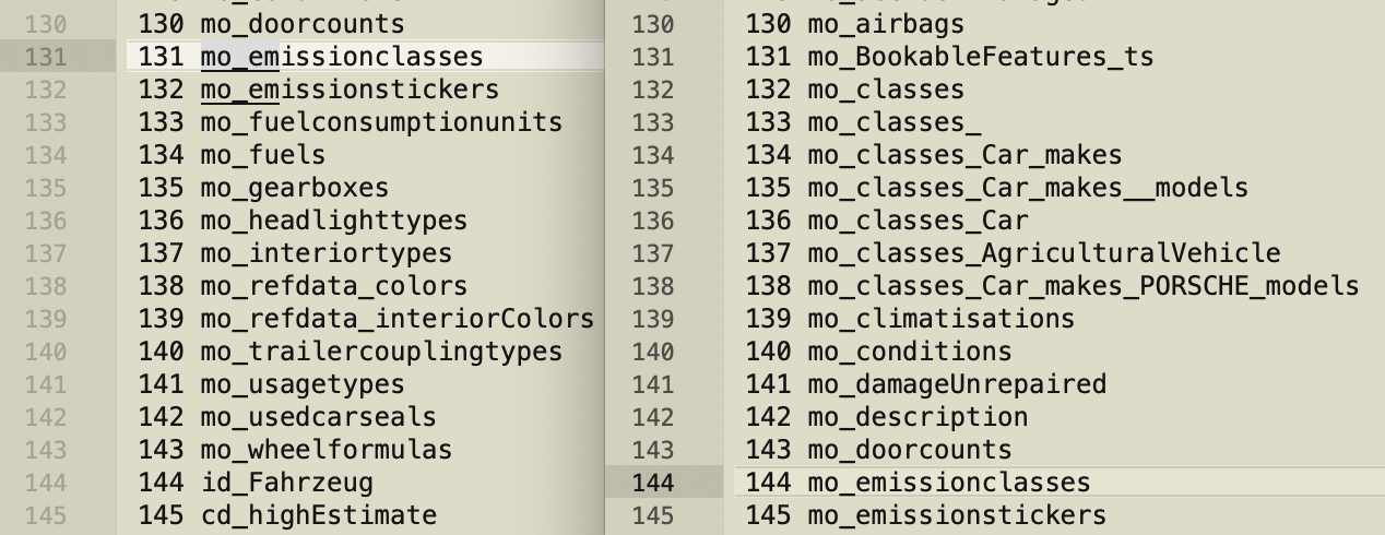

The reason why I looked up the FieldIDs and FieldNames from FileMaker_Tables was to see if I could set the ID's with ExecuteSQL. I have no idea if this will work or will destroy the whole database…
If FileMaker really uses the FieldID and not the field name at all, it might work.
