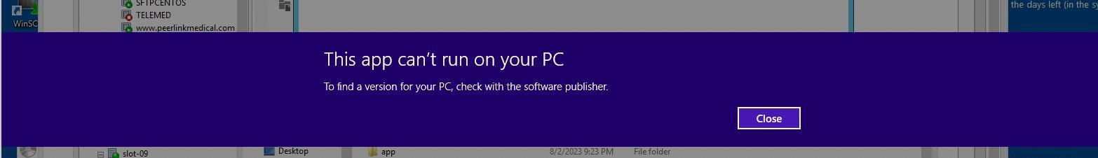

Trying to follow your suggestion to start the sync using a Windows system also does not work:
Is there any other way I can start my sync process? Command Line utility perhaps? Any Linux version? Sorry, this is mission critical for our use case and thank you!

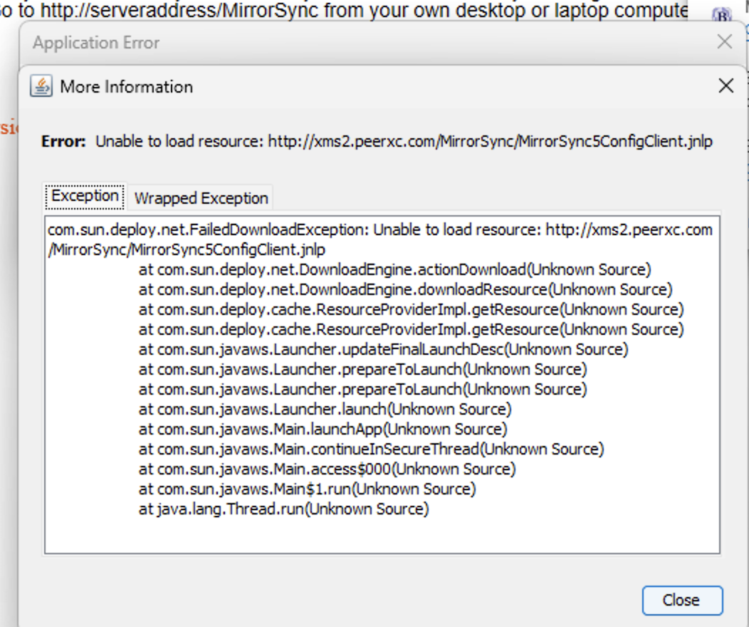

And the latest news: I believe I am getting very close to be able to run the config client on a java web start platform on Windows: only problem now being that the applet seems to look for http://server/MirrorSync instead of httpS://server/MirrorSync:
How do I update the URL it is looking for to https://
