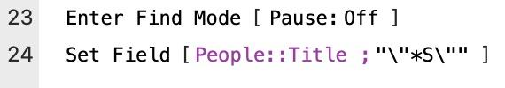

As per the above, I don't know the syntax of what it's doing. I tried this but Set Field wouldn't take it. Thanks thoughScript.jpg.267fc2d707d68accce9cea643297b79e.jpg
See the attached.
