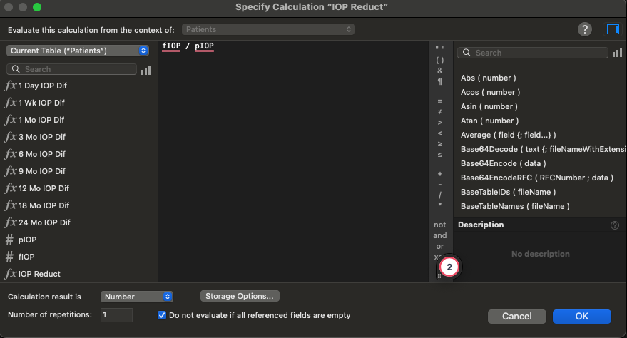

Here are screenshots of the setup. The calculation field in question is "IOP Reduct"
I am afraid I am not talented enough to tell what's wrong with your file by looking at pictures. I suggested you post a file that demonstrates the problem.
