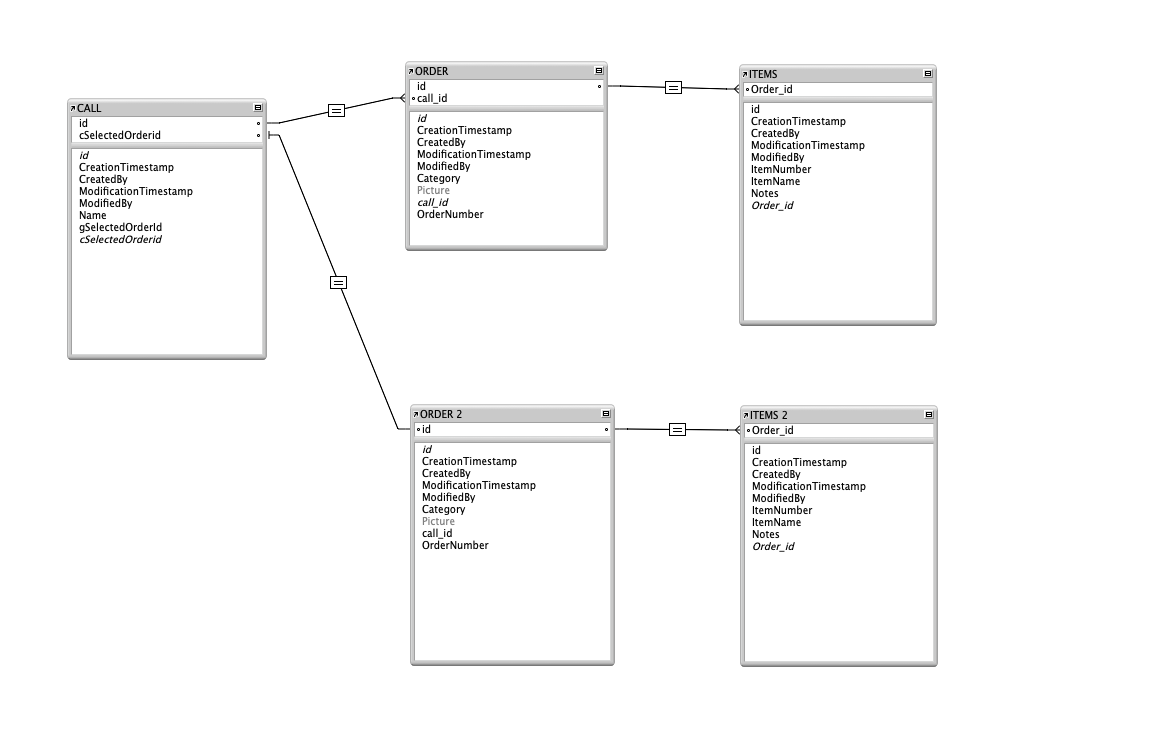

OK, let's try to do it the right way:
I created a portal on the left side of the screen referencing the orders for the call in a vertical list. Now, when I click on an order in that list I want the detail of that order to be displayed in the second portal.
To achieve that, I store the UUID of the selected order from the left portal in a global variable $$activeOrder (it works fine).
Then on the second portal (the one displaying only one row), I filter the portal according to the UUID stored in the global variable : If ( ORDER::id = $$activeOrder ; 1 ; 0 ), but it doesn't work...
I believe the answer is in this quote, but I couldn't make sense of it :
18 hours ago, comment said:
In any case, all you need to do is place the selected order's ID in a global field, and define an auxiliary relationship to the Orders table (or directly to the Items table) using the global field as the match field.
Simon

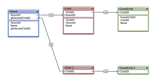

I am a bit clueless of the kind of relationship it would require.
Something like:
With this in place, you can place fields from Child 2 and a portal to GrandChild 2 on the layout of the Parent table, and they will show data from the selected Child record (whose ChildID is held in the global gSelectedChildID field) and its children in the GrandChild table.
A more sophisticated version would use an unstored calculation field instead of the global, which would point to a global variable. This would allow you to maintain a unique variable for each parent record, so that each parent retains its own selection for the duration of the session.

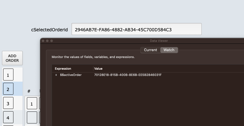

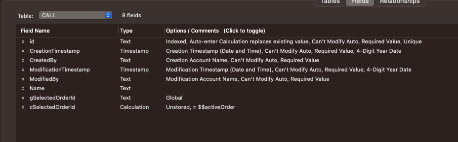

Moving forward but still far unfortunately.

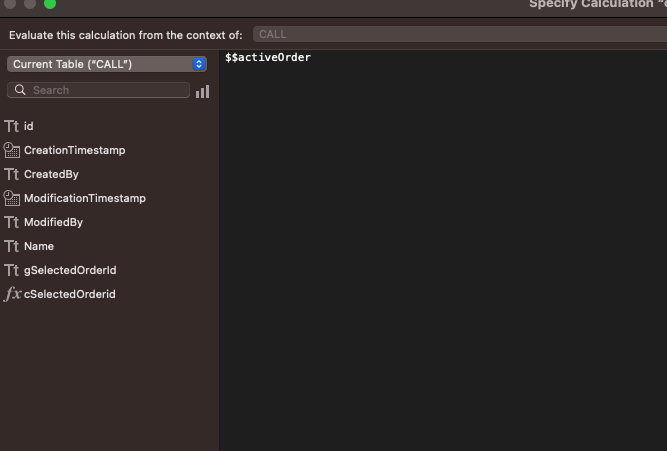

I did the table layout and relations like you said, I even went for the sophisticated version using the unstored calculation pointing to a global variable.

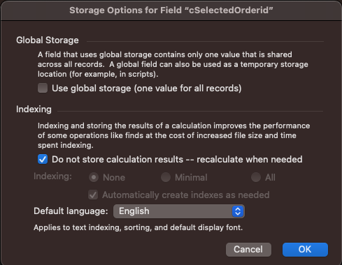

But, the unstored calculation doesn't update according to the global variable.
It will update "as needed" - e.g. when you refresh the window or a layout object that relies on it (if you choose to refresh the window instead of multiple objects, select the "Flush cached join results" option).

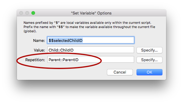

Yes, but the sophistication lies in having an independent variable for each parent record. I usually do this by defining the variable as:
but I am using serial numbers for ParentID. I don't think this will work reliably with UUIDs.

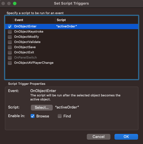

I managed to make it work with the global field. I made a script trigger on the Order portal that copy the UUID of the selected Order to the gSlectedOrderId of the CALL table :
Thanks comment for the help.
