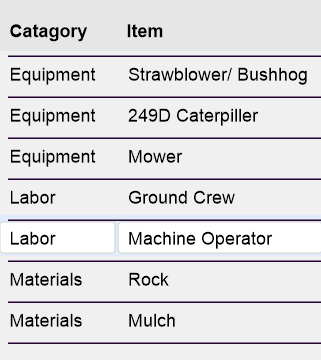

This is probably simple solution and I'm overlooking something...   I'm creating an estimate solution with all of the "Items" in first table and the second table holds each estimate for the client.  ie.  there is a long list of "items" that would be easier to choose from if the list wasn't so long.  Trying to constrict/filter the list by category.
Two tables:  Items & Estimates
Two fields:  Category and Item in both
Need the list to be filtered by the category.  I do not want to use a portal because the "Item" should be housed in the estimate.  I've tried self-joining relationships but I seem to be missing something or they are only portal based?

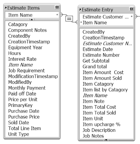

I would like to see the graph of the relational aspects of the matter, each field should seemingly only belong to one of the tables???
image.png.433dd7f4311aa279996118aa6af1d324.pngimage.png.2cc79152fe42dff2613391c0997f2413.png
Perhaps I need to change the model?
I would have preferred to have a "Material" AND "Equipment" table and pull the "Labor" from the Employee file.  As it is I've put all three together in one table.
However, in the case I have here It would be nice to select the Category and the Item List constrict to only the correct category.  I'm sure there are more elegant solutions, but this one works fine for now except for the long list I get in the Items field.

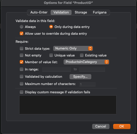

There is unfortunately a tiny flaw, it shouldn't in my humble opinion - be possible to enter a stray number without presence in the particular list, the routined user skips the selection with the valuelist ... i managed to select Dairy and following it with a productID of 4 - although Cherries hardly belong to this category!
Member of a dynamic valuelist - should be evaluated!!!
