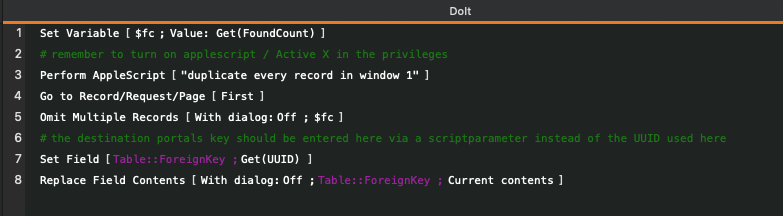

Since we're on Mac OS, could following also be pulled off, and considerably faster if on large sets of records to duplicate:

But we again look at the context, which urges to be a duplication of a record in it's entirety with all bells a whistles appearing from several portals:
https://filemakerfever.com/2006/06/
