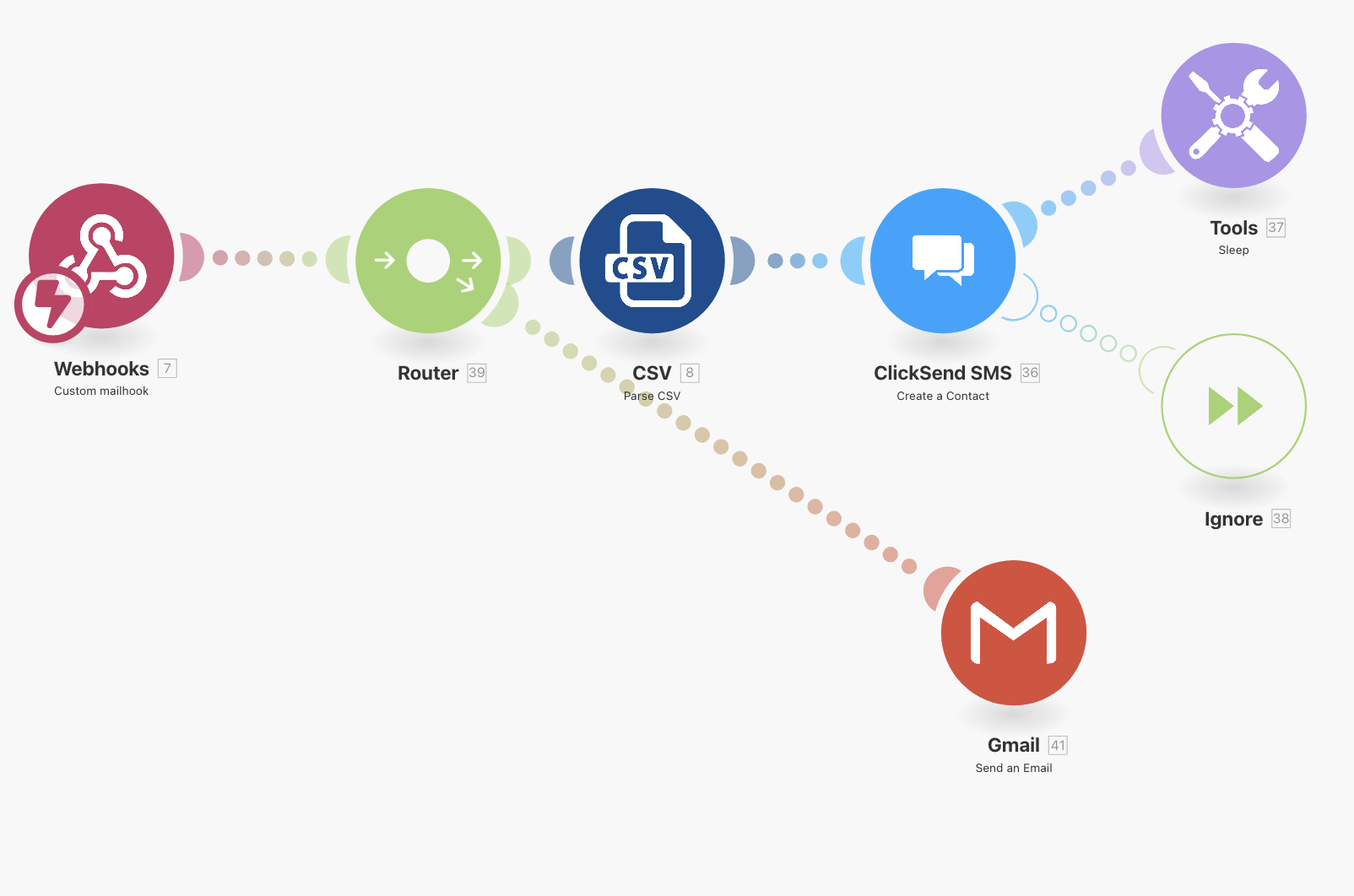

It's part of an automated process using Make.com. In order to get the data into ClickSend (I said MailChimp in error earlier), I have FileMaker server compile the data and send it to a Mailhook as an attachment. The attachment needs to be a CSV (sadly). Once it is sent over, Make.com does the work via the ClickSend API.

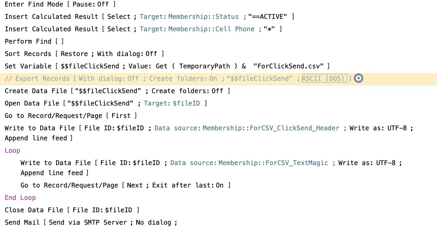

You make a very valid point @comment . The problem I am having is that the Make.com module called Parse CSV Data will not accept the CSV file being created with the Export Records Script Step from the FileMaker Server. I have no clue why Make.com doesn't like the file, I have spent hours trying to get it to work, but it dies on the first row with good data. Make.com throws an error that the row count is wrong (maybe it doesn't see the line feed?).  I've tried several formats such as ASCII and Unicode, you name it, it does not work. The Server is Windows (a FMPhost server) so I am really baffled and open to any suggestions, the fewer moving parts the better! 😁
The only way I can seem to get it to work is by using Write to Data File. For each record, I use a Calculated field that will create a CSV row with quotes and I append that to the Data File. Originally, I was used a CSV with no enclosed quotes like this:
FirstName, LastName, Email, HomeAddress
But once a comma was put into the HomeAddress field, it would kill the import because the row count would be thrown off wrong.
I fixed it now with enclosed commas to work like this:
"FirstName", "LastName", "Email", "HomeAddress"
Here's part of the code:

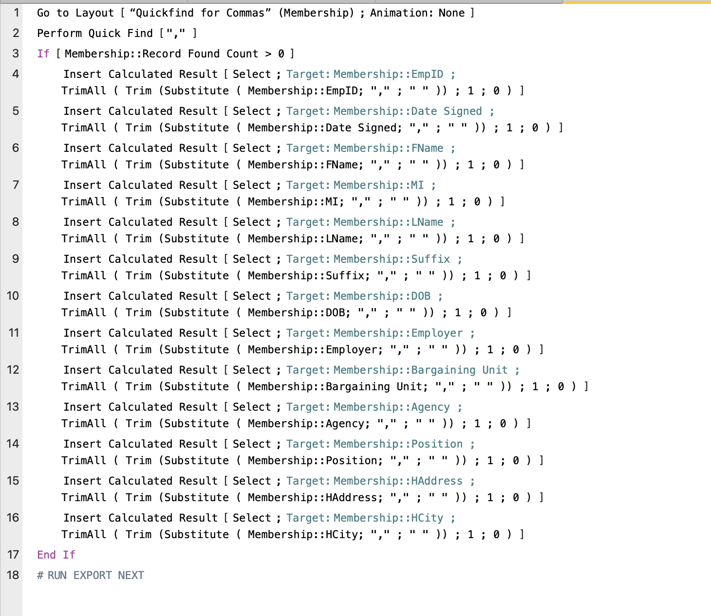

Is there a way to go directly to the field that has the comma?
There is by using a custom function like this: https://www.briandunning.com/cf/810
...where you after the quick find, by this calc:
mapexpr ( "Position ( Evaluate(_v) ; \",\" ; 1 ; 1 ) xor 0"; MiddleValues ( FieldNames ( "untitled" ; "" ) ; 6 ; 999 ) )
Returning a pilcrow delimited list of 0's and 1's showing in which field the comma should be found in ... here would I perhaps use indirection ... using the flared 1 to point at the field in question. The MiddleValues( is there to avoid searching in the "house keeping fields" as timestamp and user-indification, and by it unlikely candidates for the desired export.
But it should only be a measure to deal with already littered data, I still believe it should have been dealt with during the data entry in the first place.

Hi @comment, sorry about the confusion. When I create a CSV file using the Create Data File method, it works fine and uploads to the Make.com destination, a CSV parser. But, when I use the built in Export function, Export it as a CSV, the Make.com parser says that the first row has the wrong column count. Attached is a file that does not work called Produces Error.csv, it is created by FileMaker Server and sent via email. The No error file was created by hand on Mac using TextEditor, and it works fine.  Both are UTF-8 and I just can't determine what the issue might be.

On 4/8/2024 at 7:30 PM, Fred_S said:
Is there a way to go directly to the field that has the comma? I don't want to do this:
There is - if the damage is done:

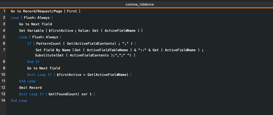

@Søren Dyhr
1. This does not "go directly to the field that has the comma"; it loops among all the fields on the layout until it finds one with a comma.
2. You could have done all that jazz with a single Perform Find/Replace script step.
3. I won't ask what if there is a field that's not on the layout, but is in the export field order.
4. I will ask this:
Why do you keep barking up this obviously wrong tree??? Do you really think that fields with commas cannot survive being exported to CSV? And, even supposing that you do, do you really think that the correct solution is to purge those commas permanently from the original data inside those fields? Really???

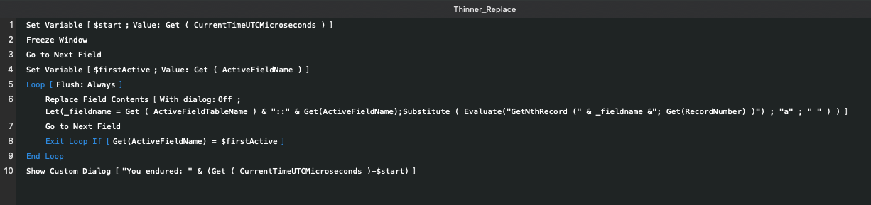

Nice one, close but no cigar - i've clocked it on a set of data from Brian Dunning, and admittedly not searching for a comma, but instead a lowercase "a" for what its worth in the comparison.
My script clocked in at 211847, while your suggestion 2. clocked in at 218352 - when using Get ( CurrentTimeUTCMicroseconds )
I turned then to scripted replaces, which suffers from the direct lack of Indirection and would then need to use Evaluate( and "headless" assignments:
But since a large number of extra calculations often are made in vain - did it clock in at 330731, even though the script is somewhat simpler, in its approach.
Edited by Søren Dyhr
I don't think this is relevant to the topic (as I said several times already).
But since there is some value to it in general:
I don't know what is the size of the data set you used. I see that the smallest set at https://www.briandunning.com/sample-data/ is 500 records x 12 fields. If you measured a difference of 6.5 milliseconds, I would not consider it significant. Especially if you only performed the test once.
Now will you finally give it a rest?
