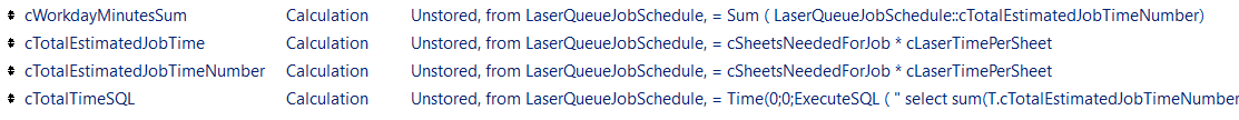

Today, as I'm splitting and redirecting tables from the front-end file to the back-end file, all of my calculations are breaking.  Before the redirection, I'd have calculations that look like this:

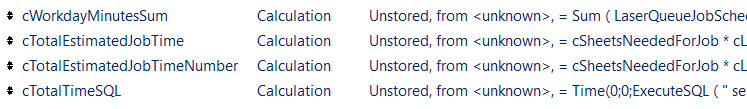

After the redirection, the same calculations no longer work, and I have this:
I don't ever remember having this problem before, but as I said, there's some rust on my brain.  Can anyone clue me in on what's going sideways here?  And I'll apologize in advance if it's a rookie error.

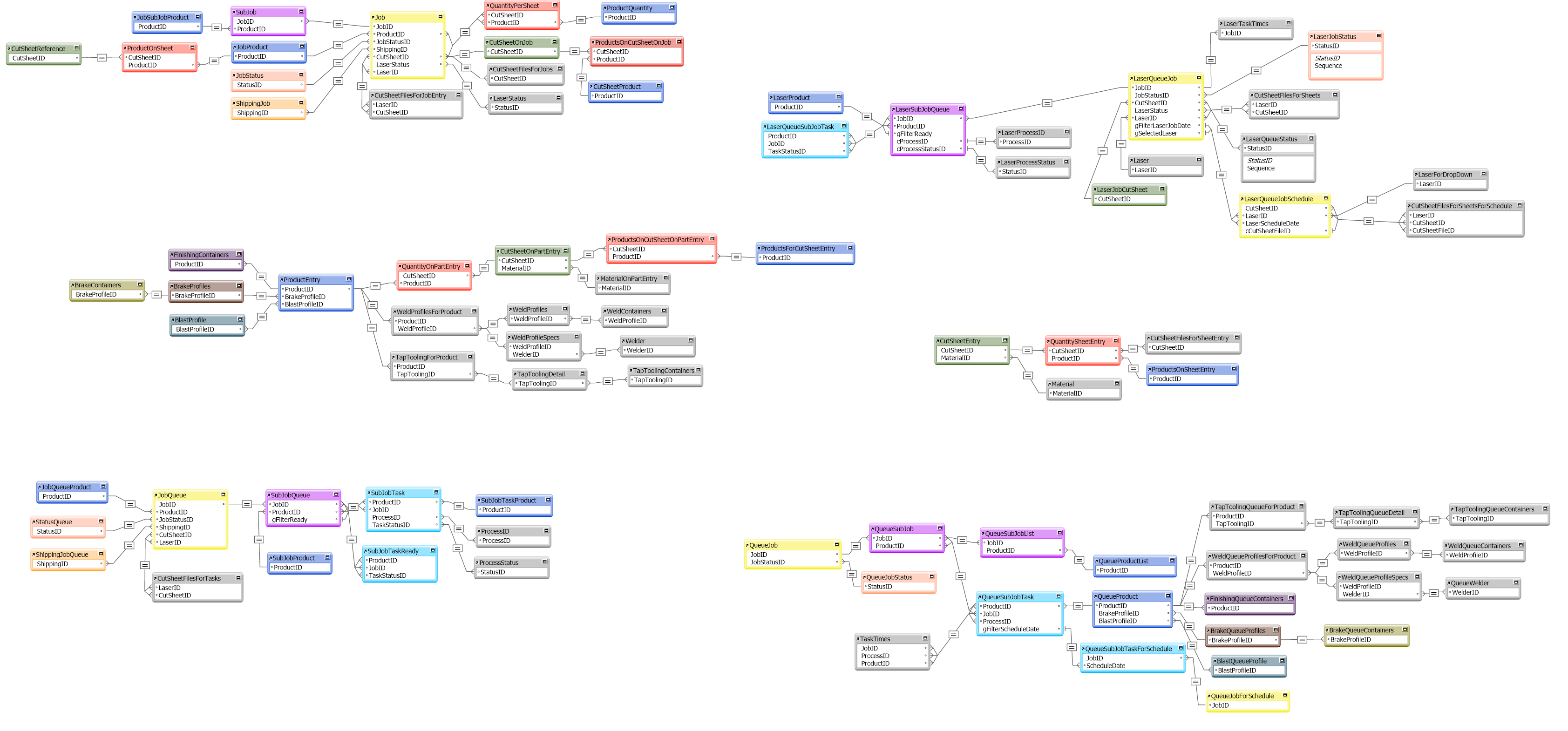

It's a bit of a complex app that tracks a complex process, each step with many parameters.  And I only have the multiples of the same calc for debugging/dev purposes - I hadn't cleaned them up yet, that's all.
This is my relationship graph.

Fair point.
After splitting the database, I was looking at the front-end file with the tables still in it, and not the back-end file.
