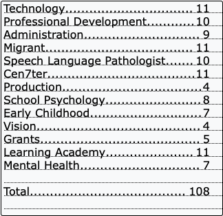

I have a calculation that works as is:
ExecuteSQL ( "
SELECT Department__lxt, COUNT ( * )
FROM ESU7_STAFF
WHERE Status__lxt = 'Active'
GROUP BY Department__lxt
UNION ALL
SELECT '¶Total' Department__lxt,
COUNT (Department__lxt)
FROM ESU7_STAFF
WHERE Status__lxt = 'Active' " ; Char (9) ; ""
...but the output of departments is unsorted. (See below.) I'd like to have the departments in ascending order, but I just can't get the syntax right using ORDER BY; how/where should it go?

The ORDER BY clause should come at the very end. But there is a problem here:
The sort will be applied to the entire result - including the "Total" line produced by the 2nd SELECT statement. If it starts with a ¶, it will be sorted to the top. If it starts with a "T", it will come before "Vision".
You could try and prepend a control character to force it to be the last - for example, this seems to work in my test:
ExecuteSQL (
"SELECT Department, COUNT (*)
FROM Staff
WHERE Status = 'Active'
GROUP BY Department
UNION
SELECT CHR(127) + '¶Total', COUNT (*)
FROM Staff
ORDER BY 1"
Char (9) ; ""
