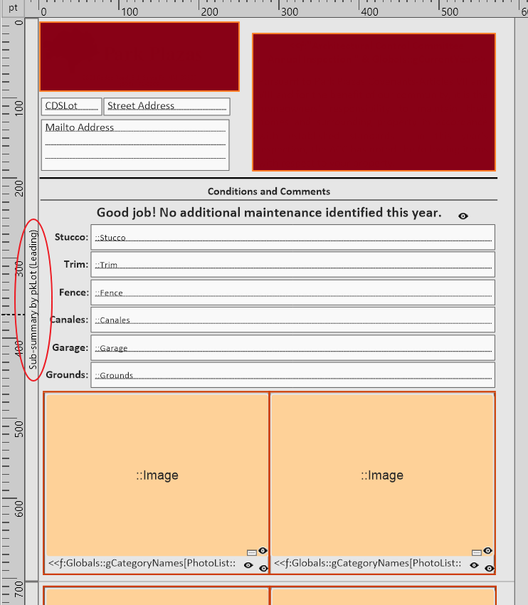

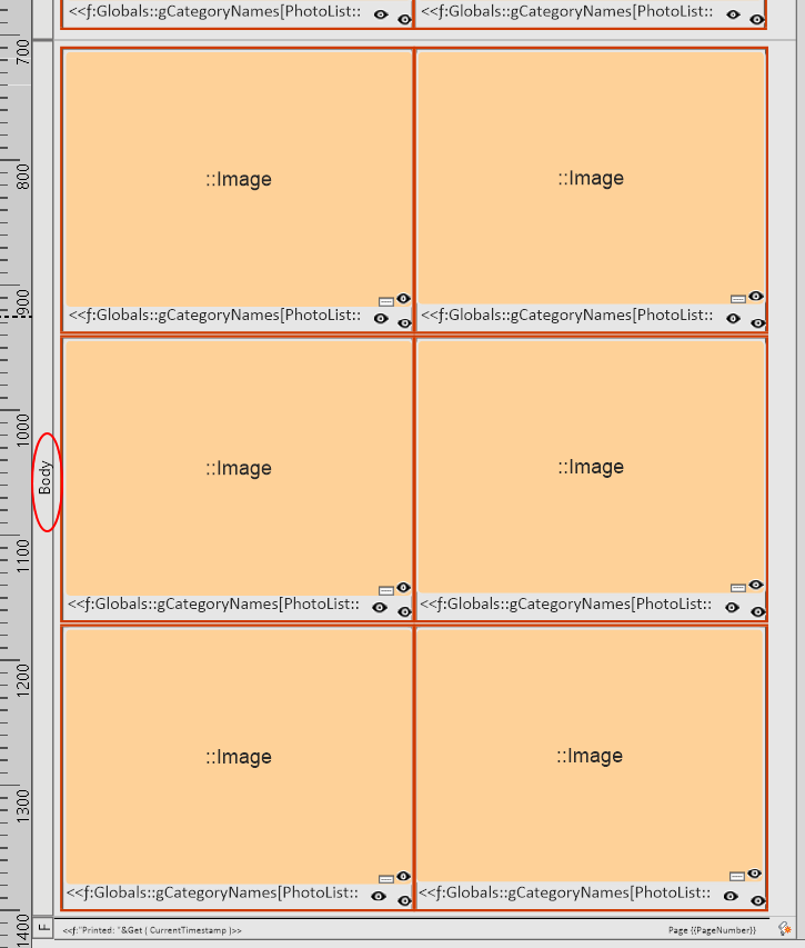

I have a layout that displays a homeowner inspection report.  The first page should show a header (name, address, comments, etc. and two of a possible 8 photos of the home.  The second page should show the subsequent 6 of a possible 8.  I set the layout up with a Sub-summary by Lot at the top to show the lot specific info and the first two photos (two single row portals starting at the record 1 and record 2 of the linked PhotoList table respectively).  Then I set up the Body with the other six photos, using 6 portals, starting at record 3-8 of the Photolist respectively.
Here's the first page = Leading sub-summary:
Here's the second page = Body:
I've tried all kinds of combinations of part page breaks, sliding and hiding objects, resizing enclosing parts etc, but I can't for the life of me figure out how to set it up so I get one page if there are 0, one, or two images and two pages if there are 3 or more images with the page breaks in the right place.  Rather than document everything I've tried and the current behavior, I figure I'll ask how to do it correctly.  Any guidance would be greatly appreciated...
Portals are not well-suited for printing. If the number of photos you need to print is not constant, base your printing layout on the Photos table, and put only the photos in the Body part. You can use columns to print the photos in pairs:
https://help.claris.com/en/pro-help/content/print-records-columns.html
And I believe you can print all your photos in bulk, without making a special arrangement for the first two.

Thanks to both of you.  I decided to go with Soren's approach - and was able to do it with only one layout, based on the Owner table.  For the page to appear to break correctly I used a kludgy workaround.  When there were more than two photos, the first page showed only a fraction of the top of the second page.  So little that when I corrected each part size to the maximum for the page (712 pixels in my case) as Soren suggested and slid things as far down the second page as I could, the only thing showing on the first page is the border of the portal row.  I fixed that by setting the format to no line.  I was even able to slide the image container down within the portal row to give a little extra top border on the second page.  Several hundred iterations I'm sure, but ultimate success.  I get that FM is not a work processor, but geez can't they implement a more predictable and effective reporting/printing scheme.  In previous solutions I have exported data to Excel simply to use its formatting and printing capabilities.   Ughh!
