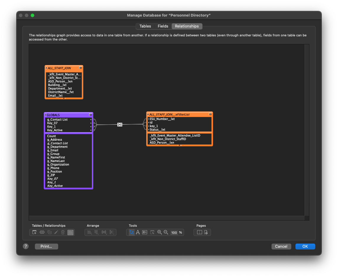

Added relationship graph from "new" file
A simplified example would be helpful.
From a casual glance It would seem that the sort order depends on some global variables? The scope of such variables is limited to the current file.
Not sure what this has to do with SQL. Using another FMP file, located on the same server, as an external data source is done natively.
Thanks--I think you answered my question: global variables are limited to the current file.
There's some SQL in a few of the scripts--mostly for the look-ups, I think.
*sigh* Such a great solution to use for what I need. Time for a Plan B.

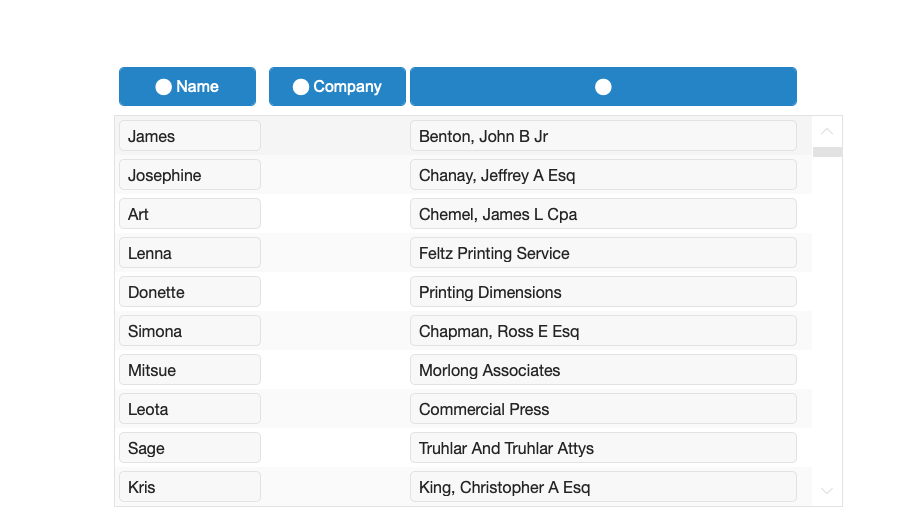

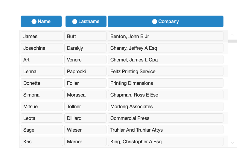

Yes but the naming showed on the button, changes as well - this happens from:
....into this, if you remove the middle column:
2 hours ago, comment said:
if later you decide to remove the PrimaryKey field from the layout
It has never been appearing in the layout anyway, why do you mention this when speaking of a current table layout, it's hardly needed?
