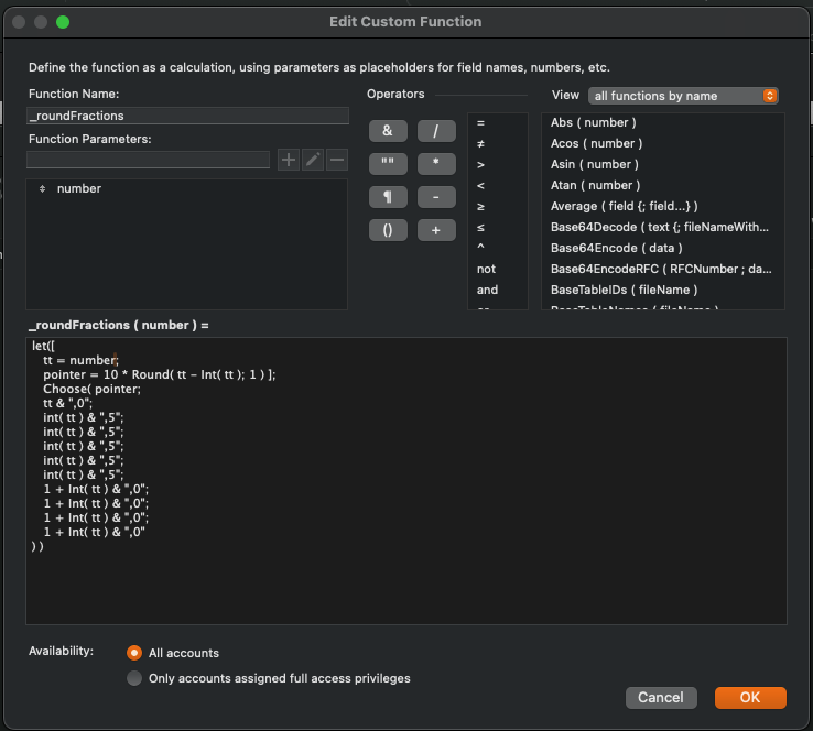

Make a custom function to tailor each fraction into a desired result:
Pease note that I use commas where you probably would use punctuations, for showing where the decimal part starts...

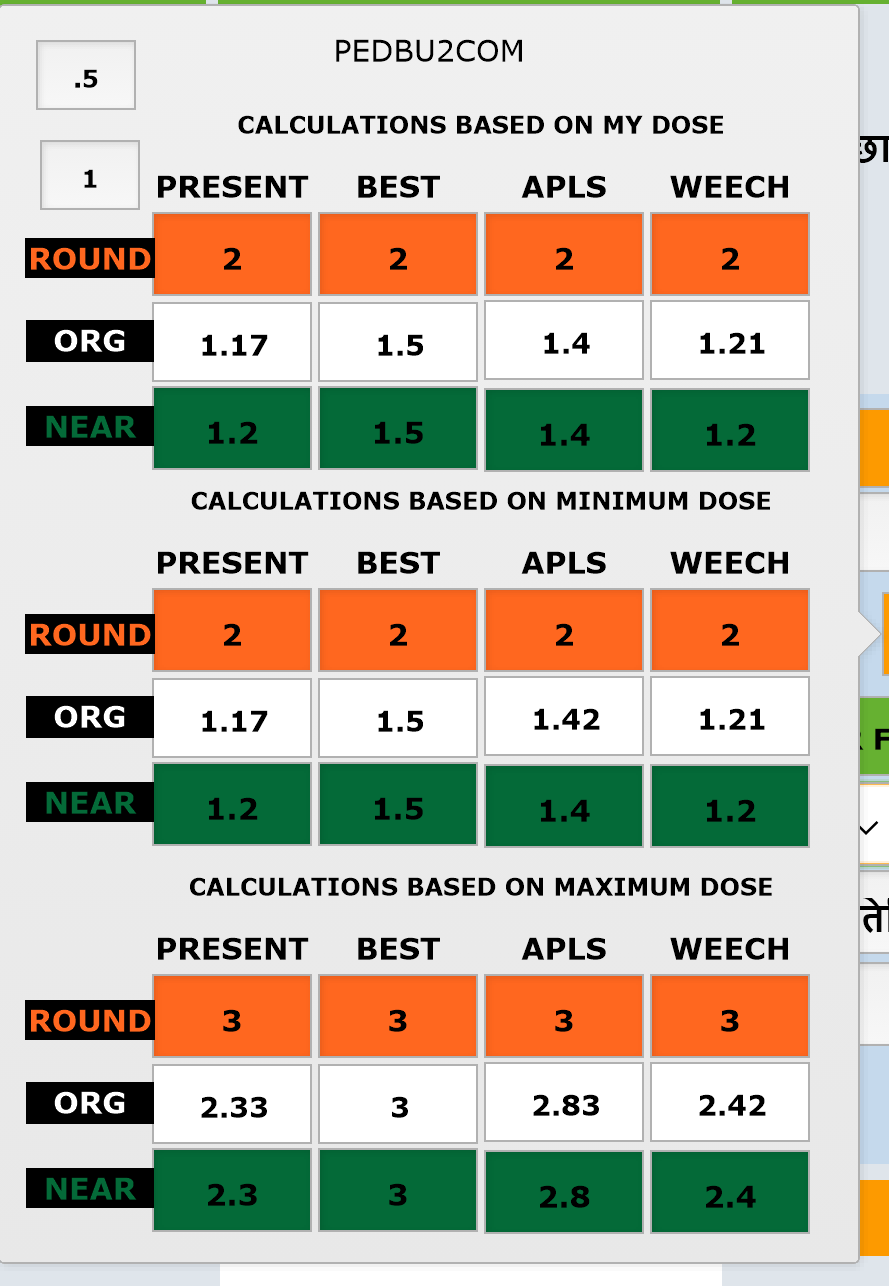

final filed is number field
i am trying to script final filed whose value is 1.2 but i want it to be 1.5
im trying to do without custom functions is it possible ??
2024-06-19 05_43_41-HOMEPAGE-1 - TABLE NAME - HOMEPAGE - RECORDS FOUND-1 - TOTAL RECORDS-1 - WEEK-25.png

oops i will explain
i made a calculation and  final result i got is 1.2 i want a calculation step so that  new filed final 2  should display as 1.5 if decimal is in between .1 to .4
hope i explained properly ??

Could also be written this way:
Let(    tt = final ;    Choose(       Min( Mod( tt; 1 ) * 10; 5 );       tt & ",0";       Int(tt) + 0,5;Int(tt) + 0,5;Int(tt) + 0,5;Int(tt) + 0,5;       tt    ) )
(if being outside europe substitute commas with punctuations...)
