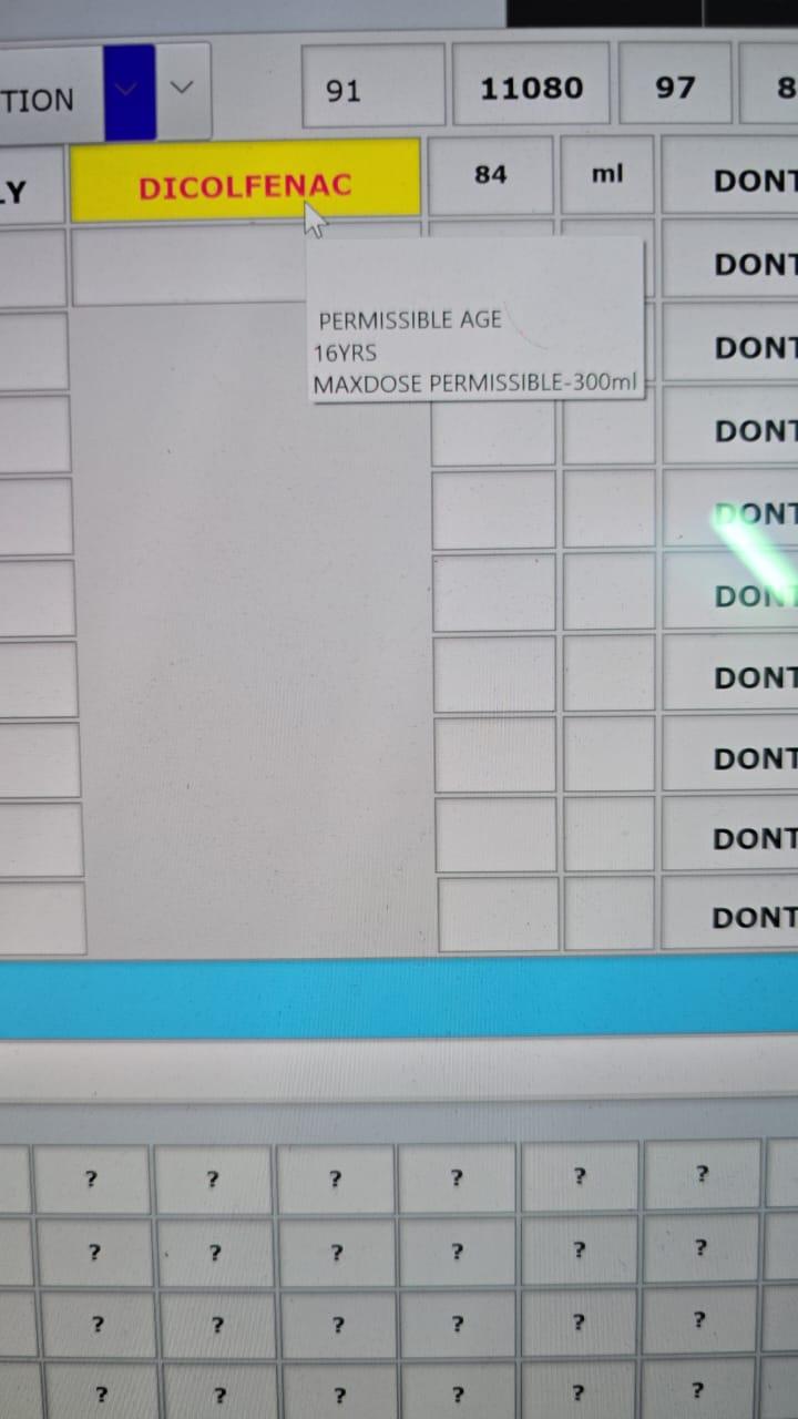

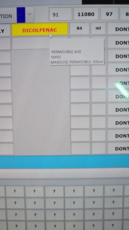

1:: SCRIPTED TOOLTIP FORMULA TO GET INFO FROM ANOTHER TABLE
If (B1::AR ALERT = 1 and B1::MR ALERT  ≠ 1  ; B1::AR ALERTS ; "" )
If (B1::MR ALERT = 1 and B1::AR ALERT  ≠ 1 ; B1::MR ALERTS ; "" )
If (B1::AR ALERT = 1 and B1::MR ALERT = 1   ;
B1::AR ALERTS & ¶ & B1::MR ALERTS ; "" )
WHEN THIRD CONDITION IS OK ABOVE IM GETTING EXTRA SPACE ABOVE HOW TO GET RID ???
