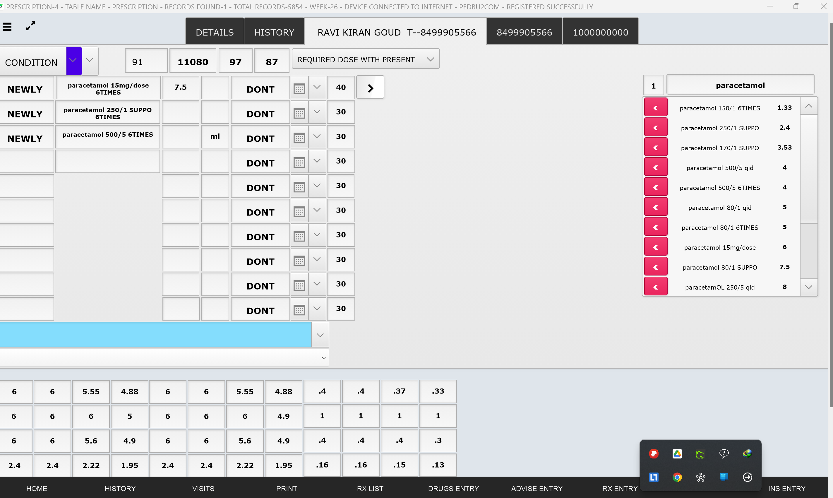

lag in tab editing
using fm 21 in samsung book 4 pro ultra 5 have set tab control on a layout when clicking field in layout mode taking few seconds to select the field any1 else having the issue or any reason ????

changed from tab panels to button bar smoothness increased but when red button on portal clicked it  closing button popover without close popover in the script now new problem :(
