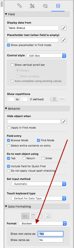

You don't need another field for display. You can format the Boolean field itself to display as as "Yes" or "No" or any other (short) strings:
Excellent! I was completely unaware of this option.
