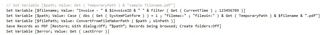

When I try to save as PDF it returns error 3. From FIlemaker Client to Filemaker Server, it is working properly.
Why are you declaring the $filePath in the first place, when not using it at all, in the following line?
I use that on the other line which is not shown on the screenshot.
I already did this but when saving as pdf it returns error code = 3
What about: Save as PDF needing "Allow Printing" in the Privilege Set
The user has full access already. This script works on client to PSOS but not working on Data API to PSOS
