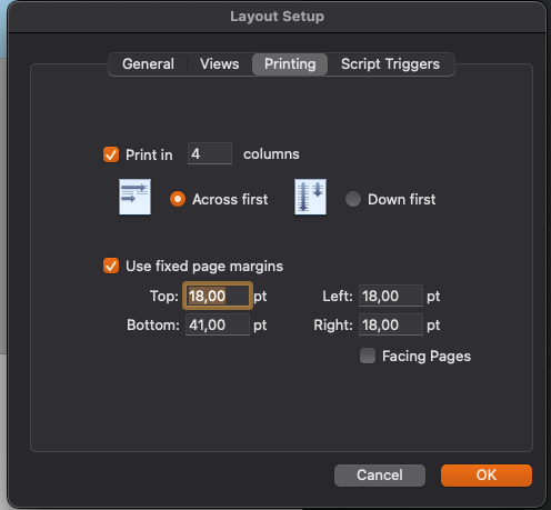

Play a little with layout setup:image.png.3d425014ddcf0989f4d6b72d2df050f7.png
Then save the found set as a .pdf, and then save it in yet another now global container, and finally render it through the webviewer:
https://community.claris.com/en/s/question/0D53w00005INDyCCAX/fill-screen-with-pdf-in-webviewer
Final part is to think up a way, to scripted single (twice) out double occurrences.
However does a way to find duplicates of a containerized by comparing Base64Encoded values .... so you can prevent eyeballing each and every one, likely to!
