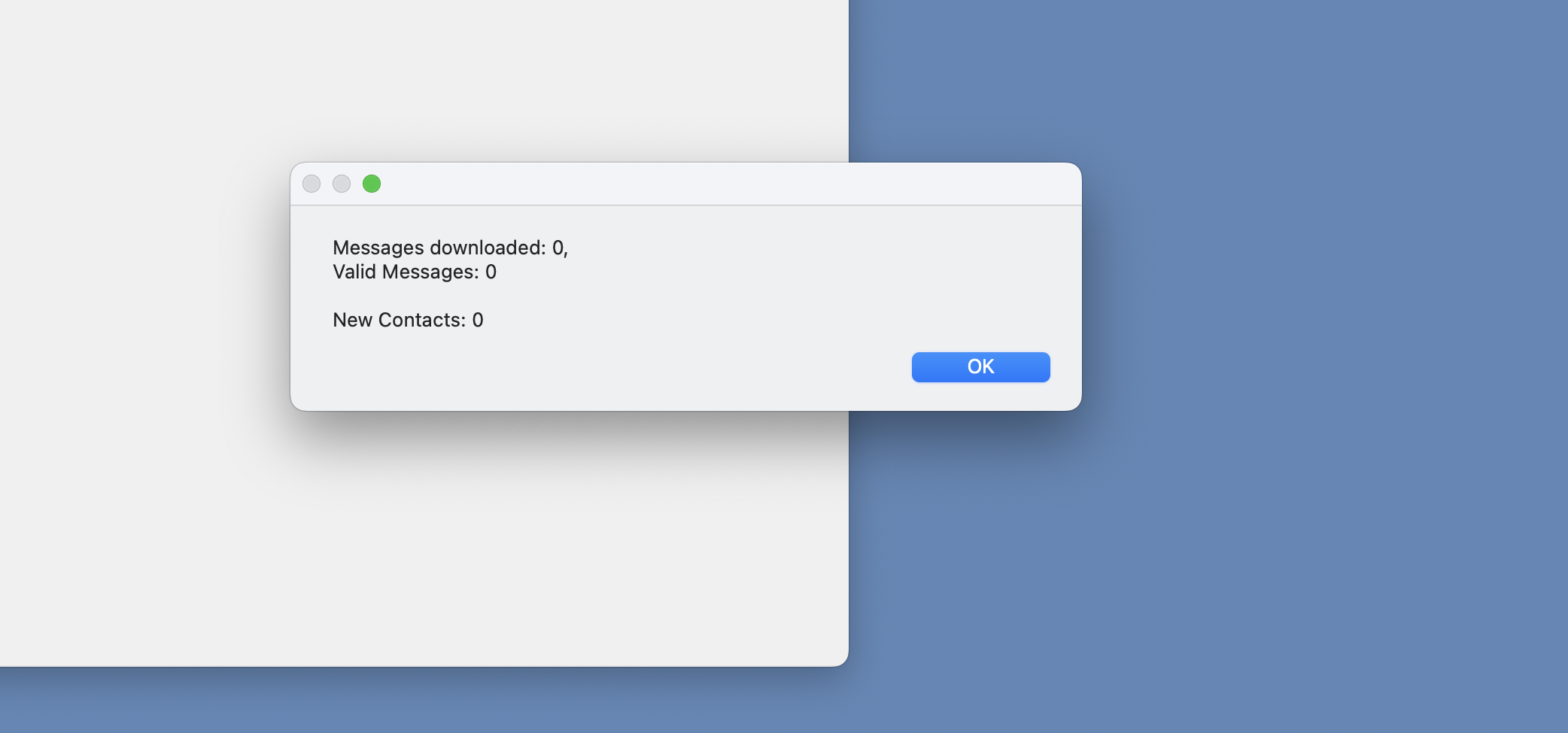

Dialogue output truncating
If I put this into the Data Viewer I get what I expect.
If I put it into a Show Custom Dialogue it truncates after $$NewContacts.
All variables are defined and have values 0.
This behaviour is different if $$NewWorkshopBookings and $$BalancePayments is non-zero
What's going on?

Just to add it seems to be an invisible line limit, 4 lines

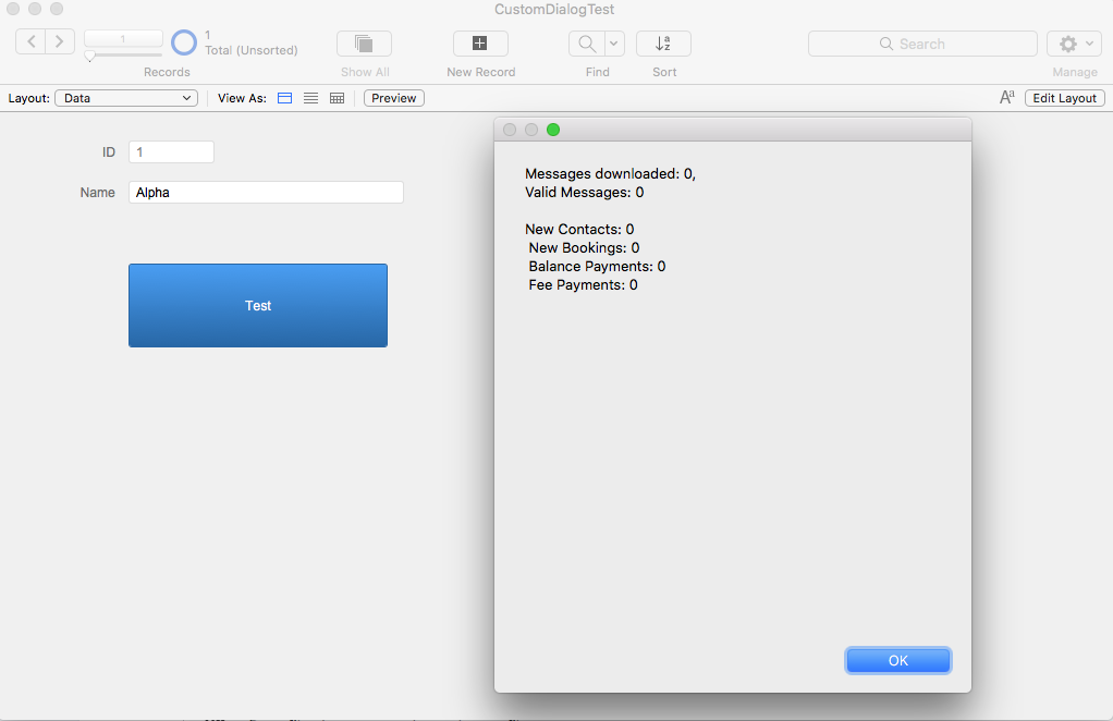

I am not able to reproduce the claimed behavior using your own code:
CustomDialogTest.fmp12
MacOS 14.6 Filemaker 19.6.3, your code.
Edited by Chris Pink
