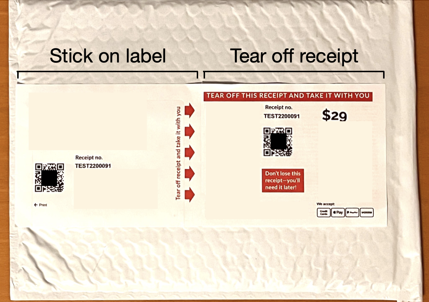

I print tear-off receipts on 8-1/2" x 11" Click-N-Ship labels. We cut the labels in half horizontally so we get a label that is 4-1/4" x 11" and is stuck on an envelope with a tear-off receipt that the customer tears off (see image). The customer then scans the QR code on the receipt and pays. I have the layout set up in Filemaker so the labels print two up. The problem is that when I cut them they are no longer in numeric sequence. I'd like to set up a sort order so that if I cut the labels in half I can simply stack them and they will be in the correct numeric sequence. So for example, ideally, if I print 100 labels, the sort order would be such that if I cut the 50 sheets in half and stack them the first stack would be records 1-50 and the second would be records 51-100. Similarly, if I print 50 labels the sort order would work the same way, or if I print 200 the same would happen. I'm not sure if I'm being clear here but would love some input. I imagine I'd have to have a sort order field that finds the number of records in the found set, divides it by 2, then creates a sequence in some way. I'm attaching images of the envelope with the label and the 2-up layout in Filemaker. Thanks in advance.

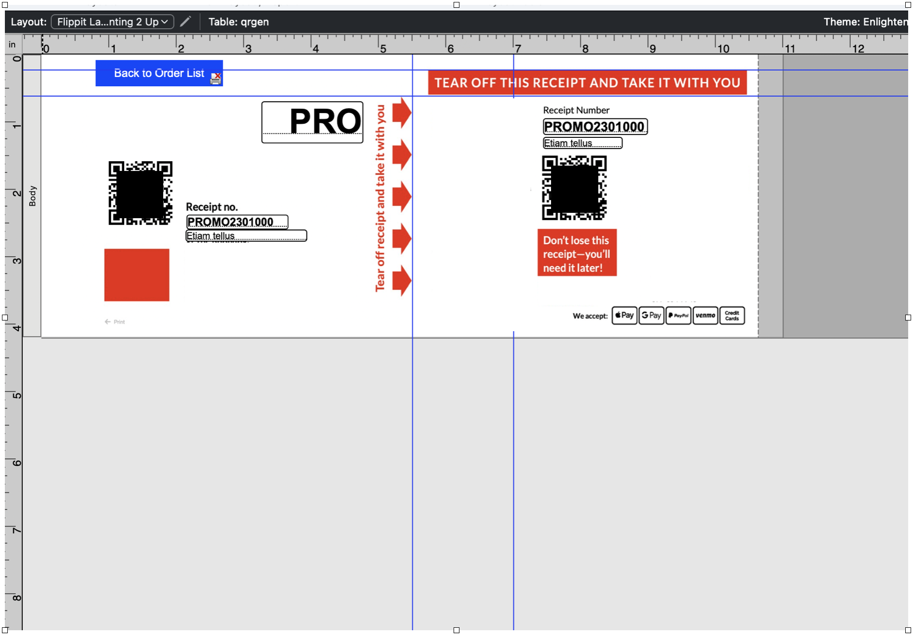

To clarify, the first picture shows the finished product, click-n-ship label cut in half horizontally and applied to a bubble envelope. The second picture shows the FM print layout with two records. Promo2300999 on the bottom and Promo2301000 on the top. A page printed landscape then cut in half horizontally. I'm attaching a screenshot of the FM Layout itself (the blue "back to order list" is a button that doesn't print in case the script stops).
