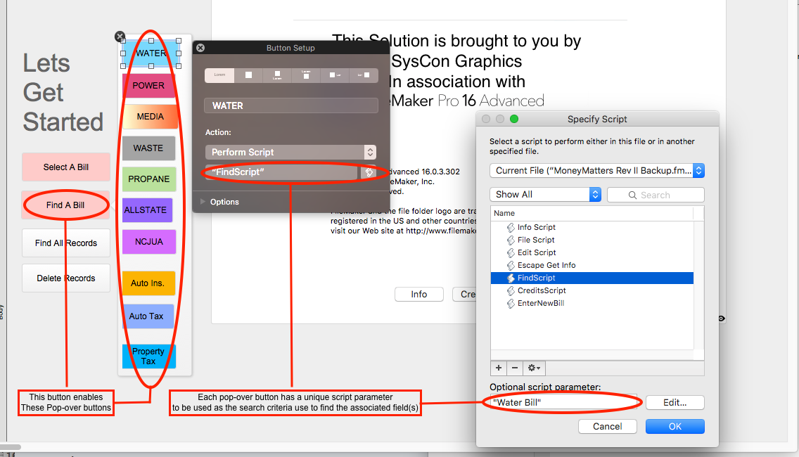

Maybe this pictorial will help some of you "get the picture" of what I'm trying to achieve here.
Please advise.
If your script is what you posted earlier, then clicking the button labeled "WATER" should find records where the BT field contains a word that starts with "Water" and a word that starts with "Bill".
You probably need to go to the appropriate layout before setting the field and performing the find.
