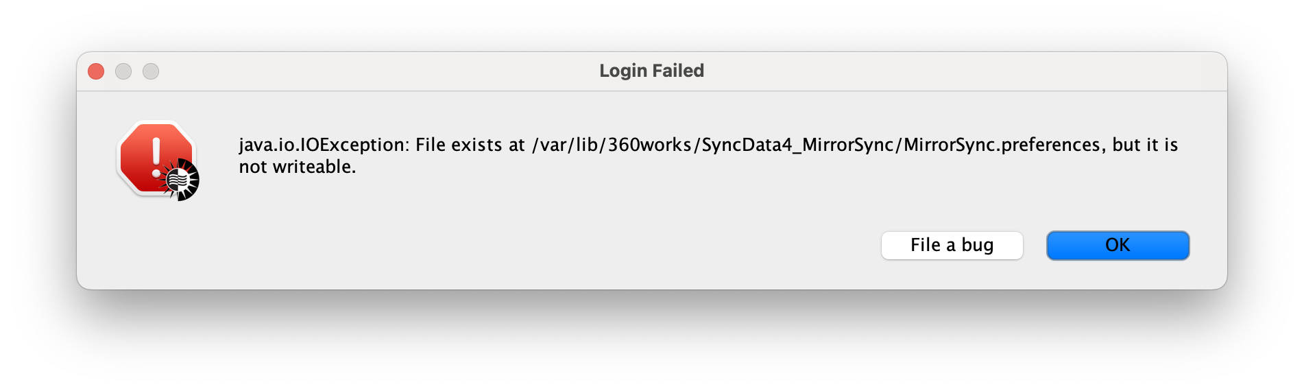

MS generating a new error
This just started nothing to our knowledge has changed ( Linux Server ) rebooting the server didn't correct the issue.
Did you recently re-install or upgrade the Ubuntu OS, or Tomcat? Our installer modifies some Ubuntu permissions to allow write access to that file. Re-running the MirrorSync installer should fix it.
--Jesse Barnum
I have not I will inquire if the hosting company did any thing, as I have no access to SSH on the linux box.

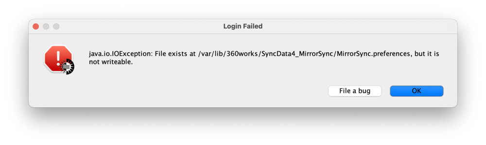

new error
java.util.concurrent.ExecutionException: com.prosc.fmapi.APIDownException: The Data or Admin API is completely down on 'localhost'. Reboot the FileMaker Server, or start the FileMaker Service. You can test the Data API at https://localhost/fmi/data/v1/databases (httpResponseCode 500) (filemakerErrorCode -1) / URL: https://localhost/fmi/admin/api/v2/schedules/backup
I rebooted the server still got this message
