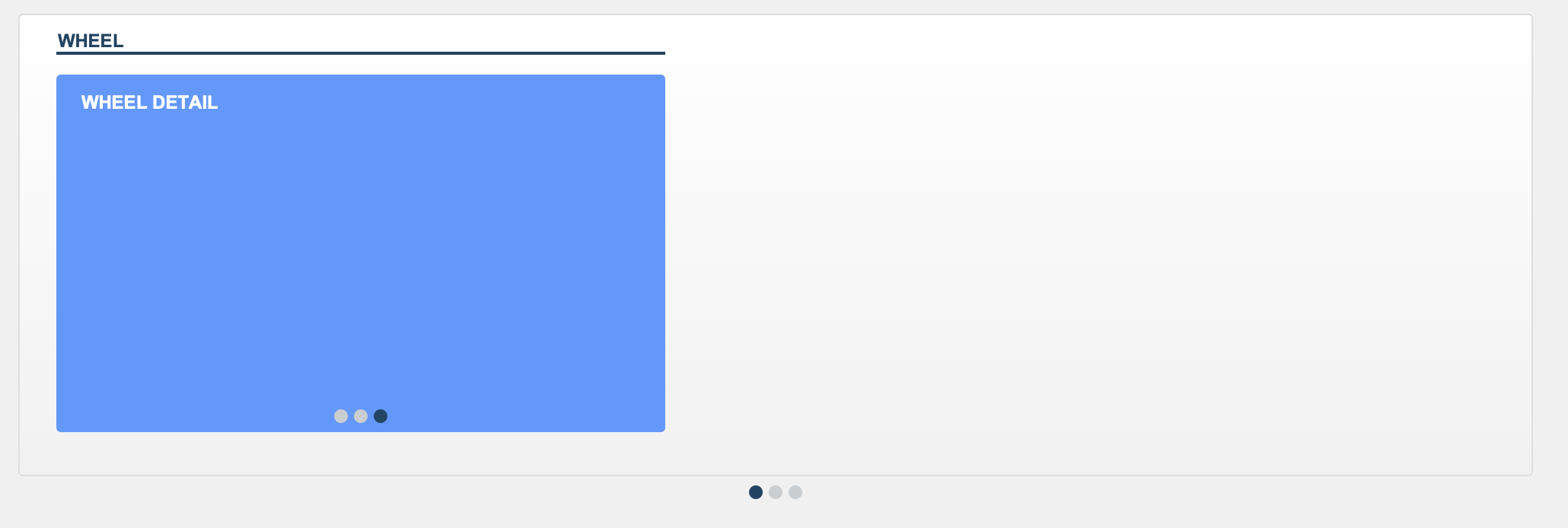

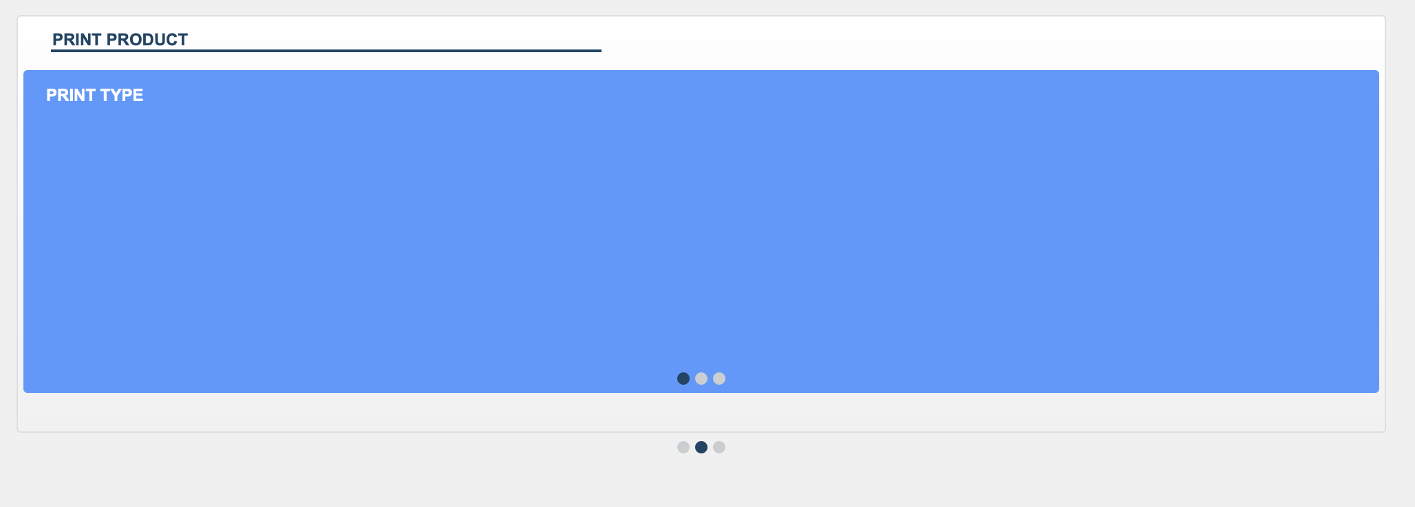

My Screenshot
  • I quickly added a Slide Control with 3 Slide Panels on my layout pasteboard, then added another Slide Control into one of the Slide Panels (nesting, if you will) and it appears to function. I have not named slide panels or scripts to test further because I thought I's ask here if I am going down a bad path.

7 minutes ago, dmontano said:
Can I place a Slide Control inside of a Slide Panel of another Slide Control?
Yes.

28 minutes ago, dmontano said:
with many different "attribute sets" (one set per significant different ITEM TYPEs) needed - how will I separate these field sets?
Quite simply: use a slide control object with a panel for each item type. In each panel, place the fields (and other layout objects) relevant to that panel's type. Use an OnRecordLoad script trigger to select which panel to show and hide the navigation dots to prevent users from overriding this choice.
(This is assuming you are are keeping the "wide table" data model. With the EAV model, the attributes would be shown in a portal.)
