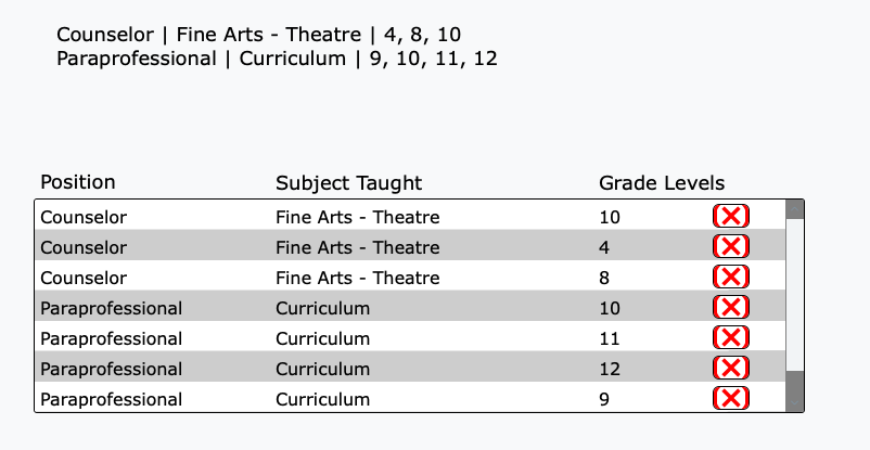

I'd like to take child records (from/in a join table) and use a calculation to create a consolidated text string list (see attached)--the data's in the portal, but I'd like the output to look like like the two lines of text above it.

Where exactly do you need this result - IOW, how do you intend to use it? It could be produced by script, a calculation field or even by export. It might be even possible to build a layout that only displays such result using a sub-summary part or a filtered portal.
It probably doesn't matter, but just in case: do all three fields belong to the join table? Or are some of them defined in one of the parent tables?

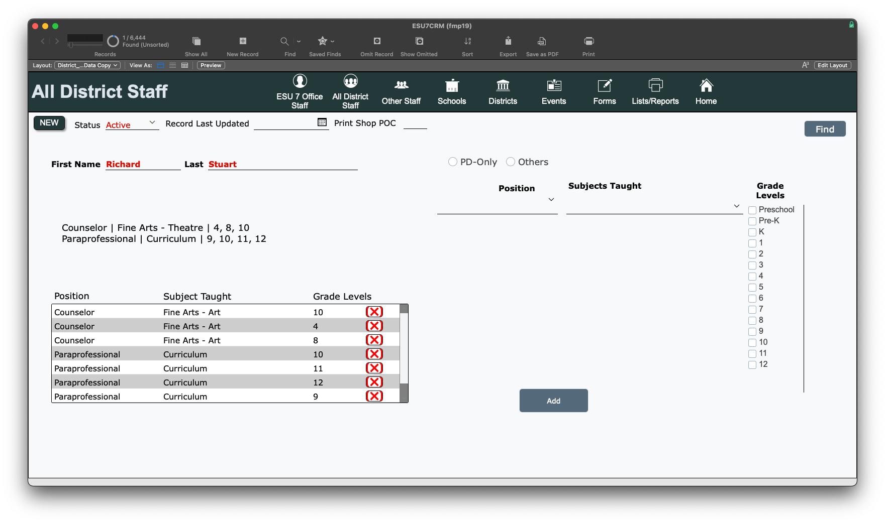

I'd like it on-screen--it's informational only and mostly for aesthetics: The layout where users choose the values consists of large, checkbox'd value lists that eat up a lot of "real estate" on-screen, so if I can have a "shorthand" version of what they choose appear on the layout where they do their data entry work, that'd be useful to them.
All three fields are in the join table, but contain only the foreign IDs of the records from the parent tables.

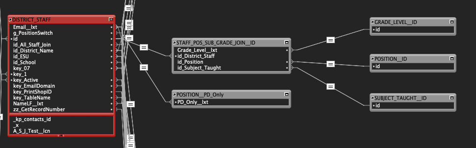

I am afraid I still don't follow fully. Please elaborate what are the tables involved here, what is the "layout where users choose the values" and what are the fields that hold the values you want to be shown in this summary.

Thanks for your patience. I've attached a screen shot from the Relationships map and the tidied-up layout with the value lists (District_Staff table). After a user chooses Grade Level, Position, and Subject Taught, she/he clicks the Add button whereupon a script "pushes" the respective IDs from the Grade_Level, Position, and Subject_Taught tables into the join table.
On edit: Maybe I need another join table between Subject_Taught and Grade_Level?
