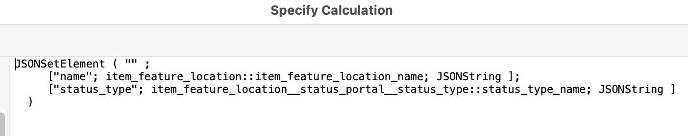

This is the JSON I have in the "Optional Script Parameter" dialog window:
JSONSetElement ( "" ;
["name"; item_feature_location::item_feature_location_name; JSONString ];
["status_type"; item_feature_location__status_portal__status_type::status_type_name; JSONString ]

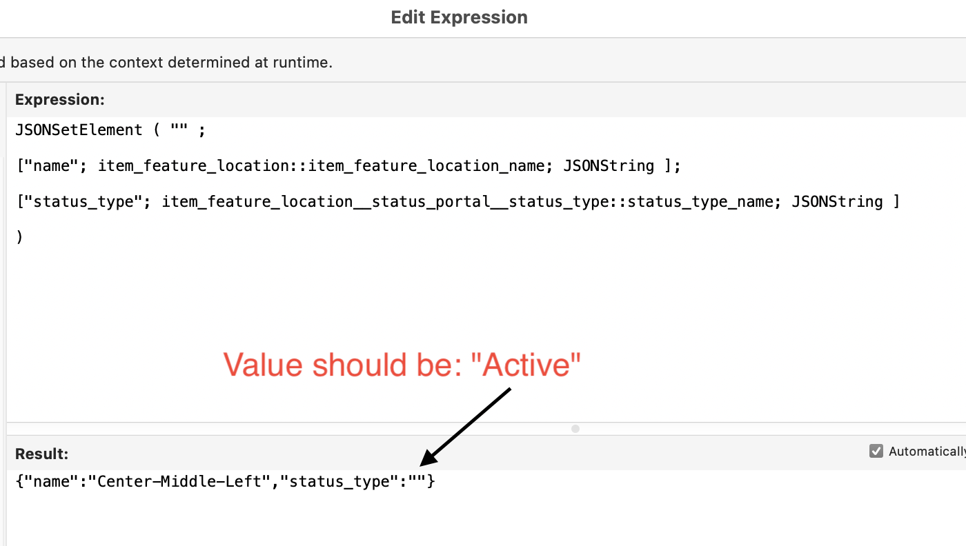

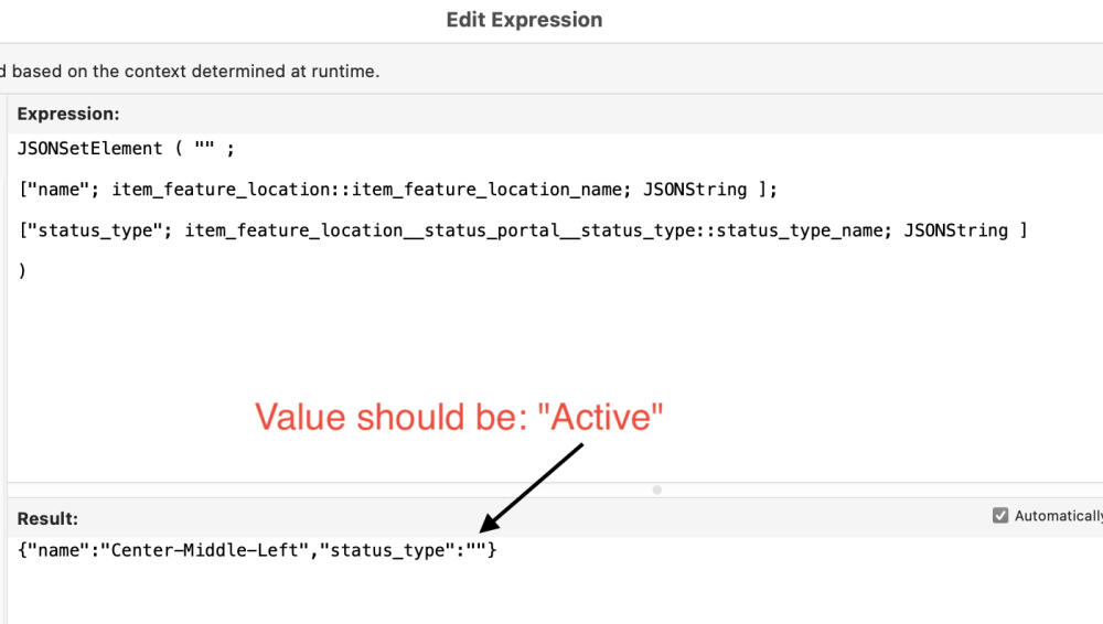

When I copy and paste the above code into the data viewer, it does give me the first parameter value, but it does not give me the second parameter value.
What Does work:
First parameter field = item_feature_location::item_feature_location_name
What Does not work:
Second parameter field = item_feature_location__status_portal__status_type::status_type_name
What I Notice
The only thing I notice that is different between the two parameters is that the second one is from a related table.

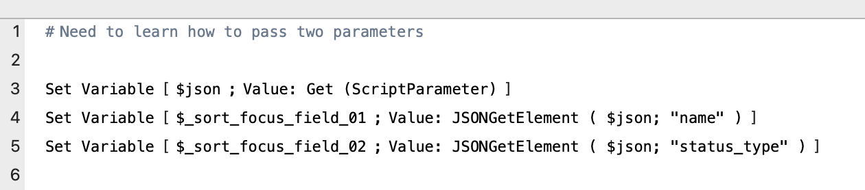

  • Script Variable of Parameters (Script)

AFAICT the problem is not with constructing the JSON but with accessing the related value. You can verify this by evaluating only:
in the Data Viewer, using the same context. I believe it will return an empty string.
Keep in mind that when referring to a related field, the calculation will retrieve data from the first related record, in the sort order of the relationship.

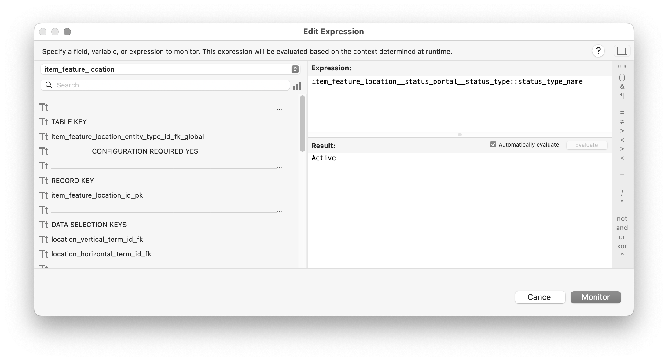

When I evaluate that related field, it is successful: see screenshot.

15 minutes ago, dmontano said:
Any other ideas?
Not really. Your formula for constructing the JSON is correct and if the referenced field contains the text "Active" you should be getting the result you expect.
Is it possible that the two tests were performed from different records?
Bingo. That must be it — because now it works.
Thank you very much!
