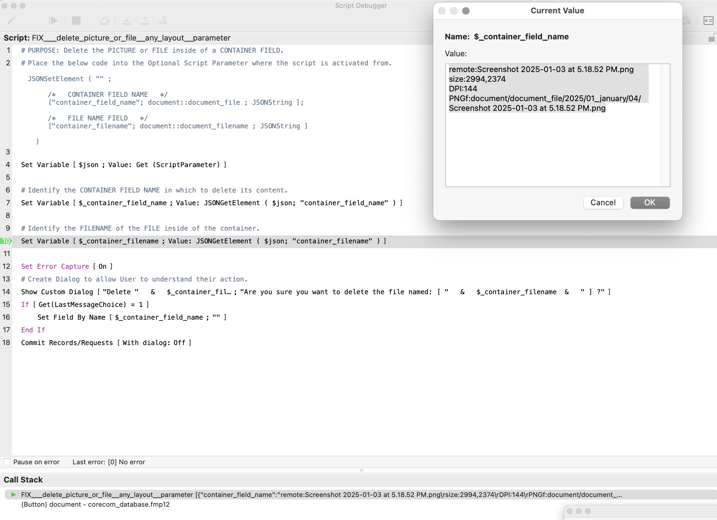

I have spent all day stuck on this script. I am trying to "retrofit" this script by using JSON to pass multiple parameters into the script. I have attached two screenshots.
SCREENSHOT NAME: script_with_variable_not_working.png
This screenshot shows all script steps, PLUS, I commented in the beginning of the script the JSON I am using as Optional Script Parameters. This screenshot also shows an overlay of the dataviewer showing the incorrect results of the variable "$_container_field_name".

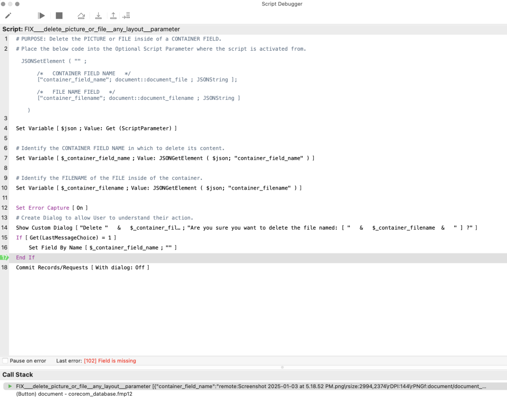

SCREENSHOT NAME: script_set_field_by_name_not_working.png
This screenshot shows line 16 throws the error message in red at the bottom: [102] Field is missing
I strongly suspect the problem lies is me trying to pass the field name of a CONTAINER type field using JSON. As a test, I tried switching to a TEXT type field and I was able to pass that as a variable.
From what I can see the problem is that you are passing the container field's value instead of its name.
Try defining the script parameter along the lines of =
JSONSetElement ( "" ;
[ "container_field_name" ; GetFieldName ( document::document_file ) ; JSONString ] ;
[ "container_file_name" ; document::document_filename ; JSONString ]
