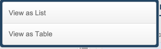

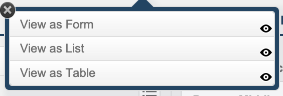

I have the buttons and the scripts working just fine that go the various Layout Views
See screenshot:   3_button__button_bar__layout_mode.png
In addition, I am hiding the particular button as a possible selection if that button matches the layout view the User is currently viewing. I am achieving this by using "Hide Object When". For example:
  • If User is currently in "Form" view, the hide calculation for the "View as Form" button is:   Get(LayoutViewState) = 0
  • If User is currently in "List" view, the hide calculation for the "View as List" button is:   Get(LayoutViewState) = 1
  • If User is currently in "Table" view, the hide calculation for the "View as Table" button is:   Get(LayoutViewState) = 2
See screenshot:   3_button__button_bar__browse_mode__1_button_hidden.png

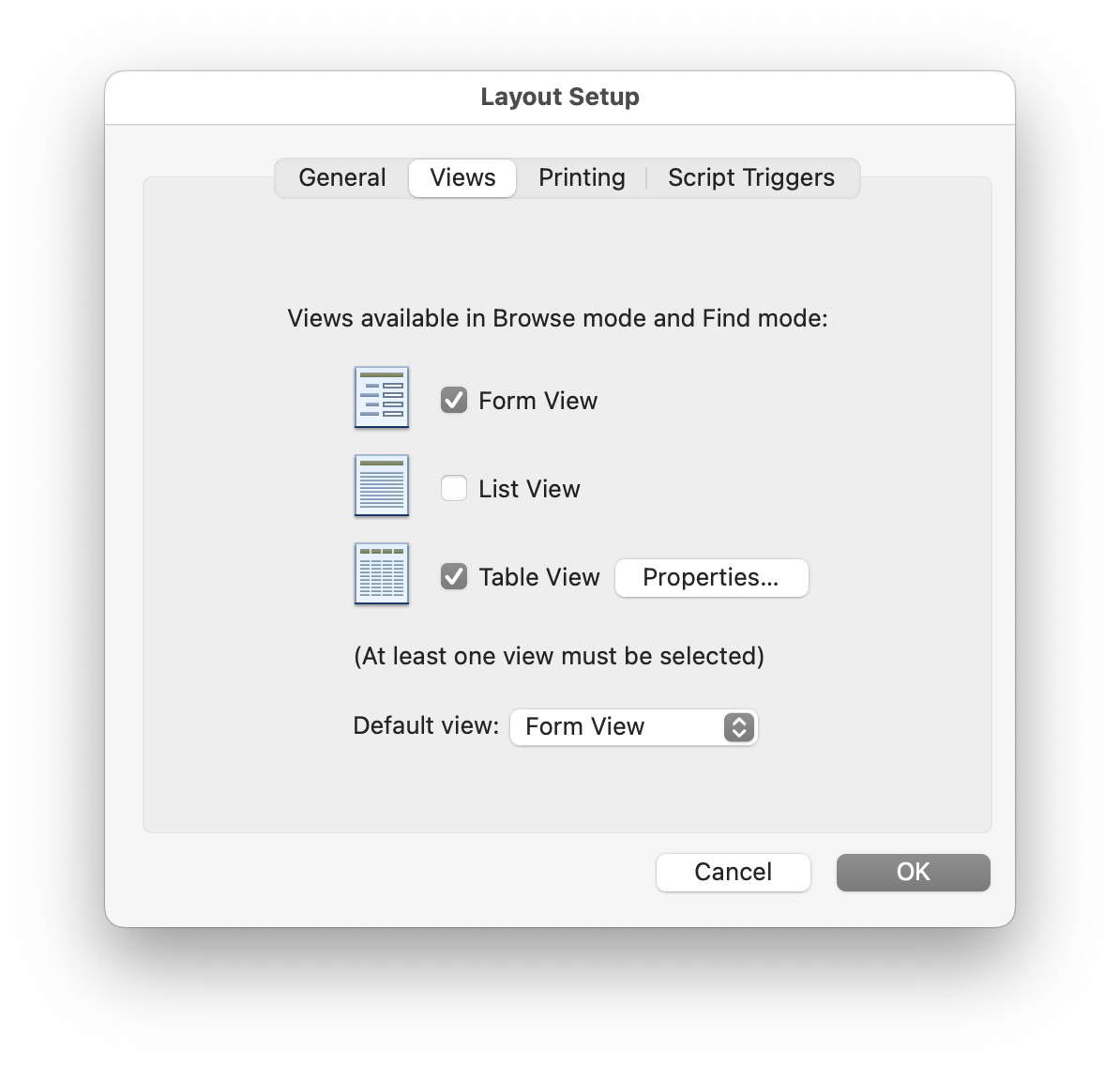

How to "hide" a particular button (View as Form, View as List, or View as Table) based upon if the Layout View option is disabled by the developer to begin with.
See screenshot:   layout_setup_dialog.png
Is there "function" that would allow me to test if a layout view was disabled by the developer? If so, I would be able to set a hide condition.
Is there a function equivalent to my MAKE-BELIEVE FUNCTION I'm calling Get(LayoutViewEnabled)?
Which would maybe return a "0" for Form; a "1" for List; and a "2" for Table.

If I do so, Users can enter any of the views even if, I as developer, have deselected the option to "View as" in the Layout Setup up dialog settings.

What I find interesting is FileMaker itself - when Status Toolbar is active - dims any of the "views" that have been disabled. So there is clearly an underlying mechanism that does this - its just not available in any way that I can find. If FileMaker created a function that gave us the ability to test for whether a particular view was enabled or disabled would be good.

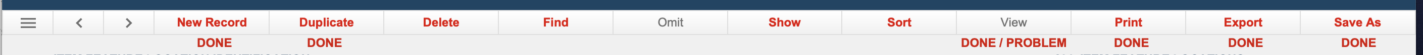

I am currently building what I call a "function bar", that when complete, I will "copy and paste" on all of my layouts. In order for this to work, I have been "parameterizing" these buttons and building scripts to work with these parameters: this has been a long and arduous task (for me). I don't think your statement applies negatively to what I am trying to do, but rather highlight that "if" I need to edit this "function bar" of mine, that I will need to edit all instances of it.
If I am correct that the operative word is in fact "share", I wholeheartedly say that I wish FileMaker had the ability to allow us to build an Object in one place, and deploy it in multiple places. If a change is needed, we change the "one" object" and all instance of that object are updated.
I have attached my "function bar" (object) in its current development state (using conditional formatting "RED & BOLD" that only an Admin can see to highlight which button/script will need its parameters customized per layout), and a manually added text status below each button of DONE if I think I have finished the segment.

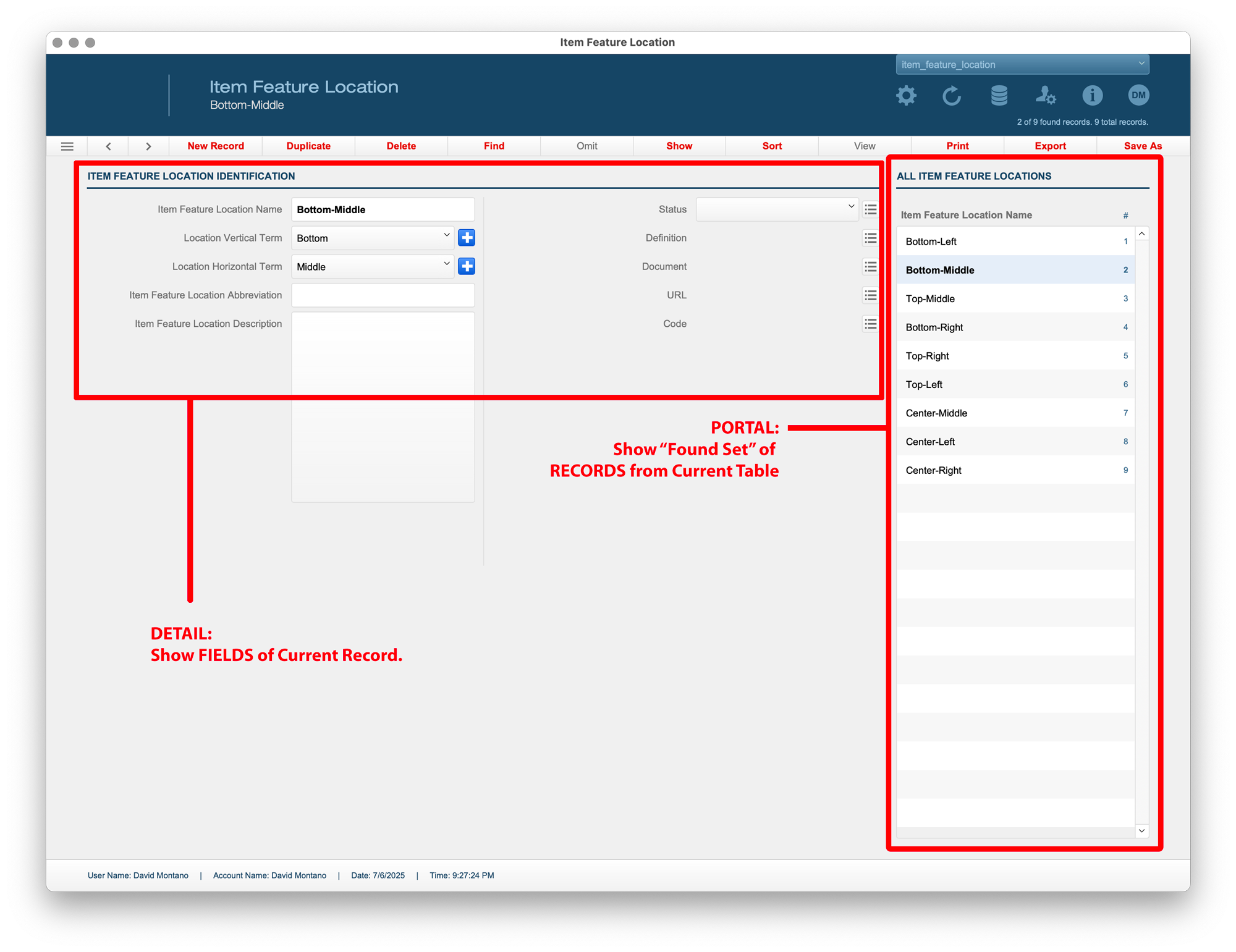

On 7/5/2025 at 1:42 AM, comment said:
Also keep in mind the possibilities offered by list-detail layouts.....)

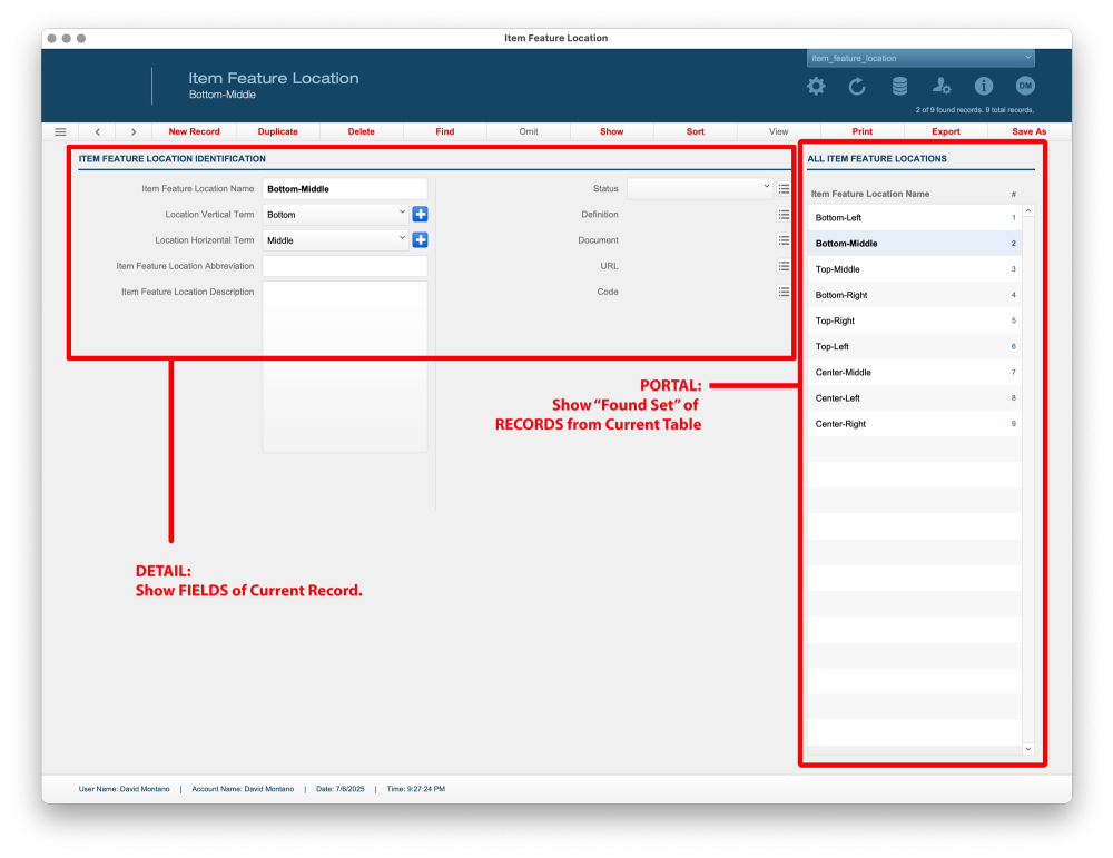

I believe I am currently utilizing what you are referring to by "list-detail layouts" as shown in attached screenshot titled "list_detail_example.png"

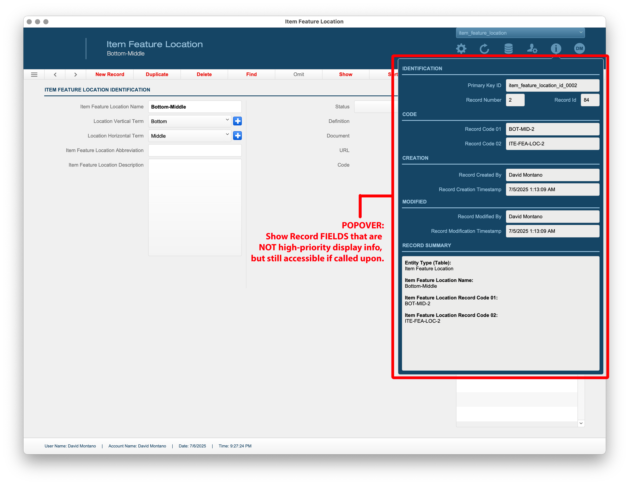

Also keep in mind the possibilities offered by ........, popovers and card windows.
I believe I am currently utilizing what you are referring to by "popovers" as shown in attached screenshot titled "popover_example.png"
I "think" you may be pointing out that I might be able to use a POPOVER or CARD WINDOW in which to show a LIST view-type of presentation? I may be assuming a bit much here.
Actually, it's quite the opposite: you would have a List layout to show a bunch of records (typically non-editable). Then you use a popover or a card window to drill into a specific record for more details and/or editing. It's functionally similar to list-detail layout but you have more space to work with, since the detail temporarily conceals the list.
