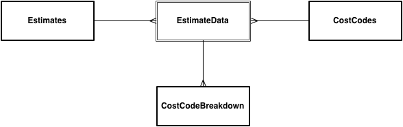

If I understand this correctly, you want to have a basic structure of:
with a calculation field in the EstimateData table to add up the "local" cost (entered in the EstimateData record) together with the costs entered in the child records in CostCodeBreakdown.
Please note that the relationship between EstimateData and CostCodeBreakdown needs to be based on matching an EstimateDataID value (the primary key value of the EstimateData table), not the CostCode value (or at least not the CostCode value alone; it could be based on both EstimateID and CostCode).
Then you want to have a 2nd occurrence of the CostCodeBreakdown table linked directly to the Estimates table, matching on a global EstimateDataID field defined in the Estimates table. This would be the TO to use for your 2nd portal, showing the breakdown for the currently selected EstimateData item.
P.S. Consider simplifying things by entering everything into the EstimateData table (even if it means having duplicate CostCode values there) and then just summarizing the items by their CostCode value, as I explained in my previous post.
