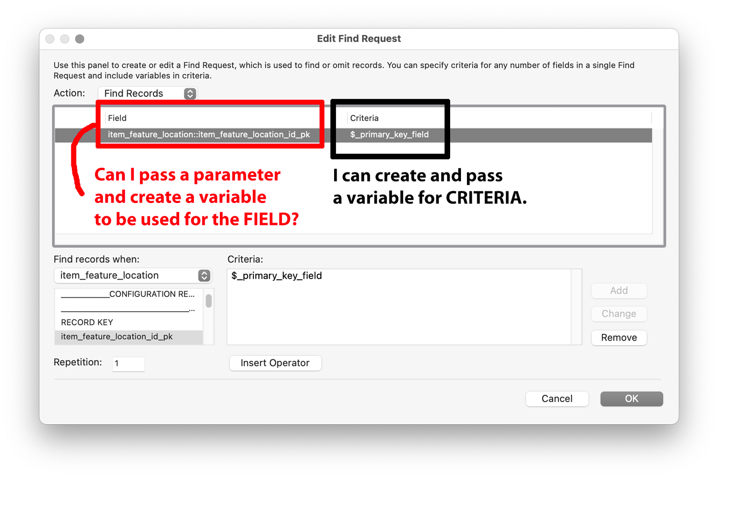

Perform Find - Edit Find Request: Is there a way to pass a parameter and use as a variable for the "FIELD" in Edit Find Request?
Hi all,
I have a script that I would like to use in multiple "similar" situations.
To do this, I need to pass a parameter to set a variable for it to FIND a record in the PERFORM FIND script step - specifically in the EDIT FIND REQUEST dialog (see screenshot attached).
Any help is appreciated, thanks.
You cannot use a variable to specify the field in the Edit Find Request window.
But a find request can also be constructed through setting fields -  and then you can use the script parameter to select which field to use, similar to what we discussed only recently here:
https://fmforums.com/topic/110860-script-problem-remove-container-file-from-a-record-trying-to-transition-to-json-to-pass-multiple-parameters/#findComment-494081

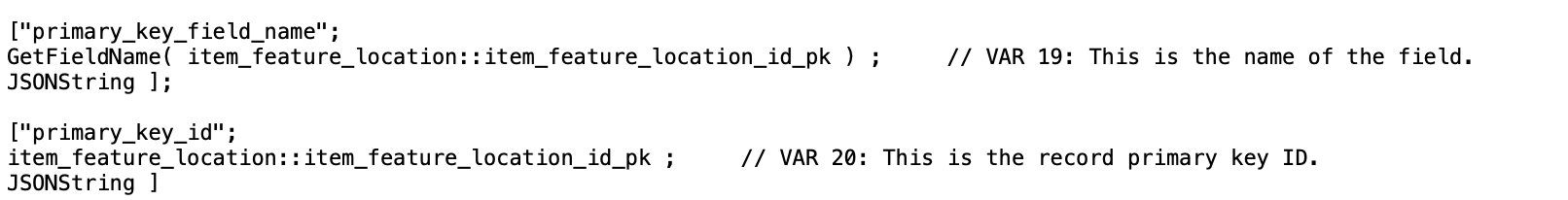

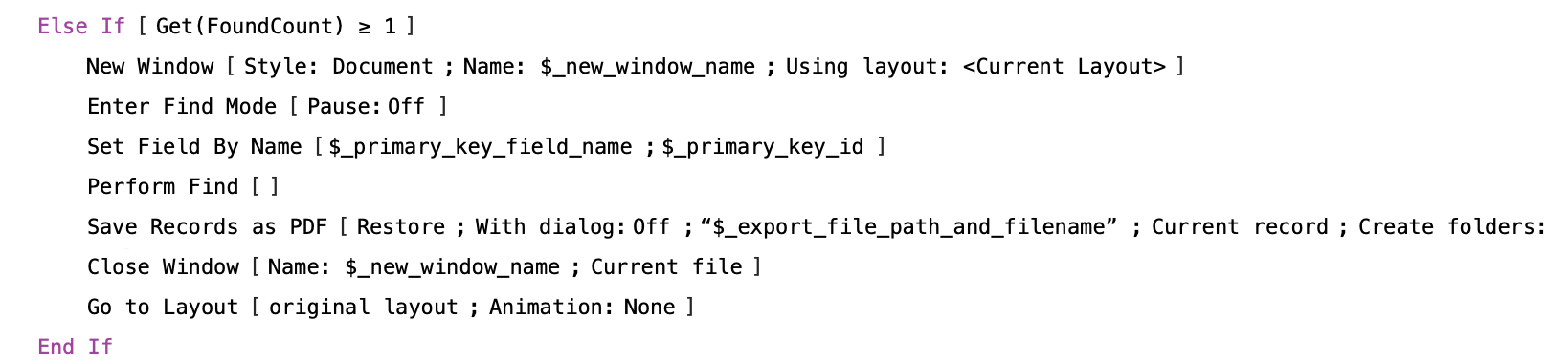

It took me a while to figure out what you, ultimately, clearly explained! I did get this to work. The trick for me was to use the "Enter Find Mode" script step instead of just the "Perform Find" to get my variables to be utilized. I believe I implemented this correctly...?
Using "GetFieldName" function in a similar way as you prescribed in the link you referenced helped me understand the need to - at times - get either one of these two parameters. I certainly suffer from "can't see the forest for the trees" and trying to improve.
I have attached two screenshots:
  1. The parameters I passed to script
  2. Script steps I used
Thank you!
