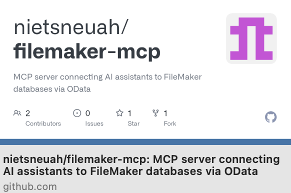

Announcing filemaker-mcp — Connect FileMaker Directly to Claude AI
I'm releasing a tool I built that I think the FileMaker community will find useful.
filemaker-mcp is a Model Context Protocol (MCP) server that gives Claude — Anthropic's AI assistant — direct, structured access to your FileMaker solution. Schema, data, analytics. No copy-pasting field lists, no explaining your data model in every prompt. Claude just has it.
github.com/nietsneuah/filemaker-mcp
