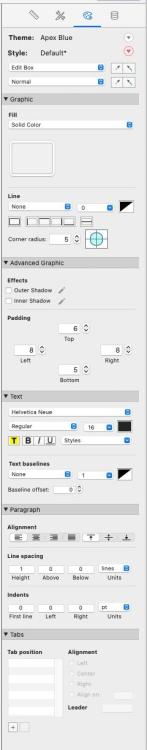

Inspector, for field one (the one I want to paint to another field):
Appearance > Text > set to Bold

I've tried that on the Style Edit Box area, but the font does not change to bold.

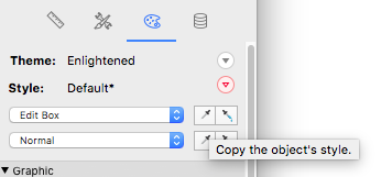

In the Appearance tab of the inspector click the top left pipette button:image.png

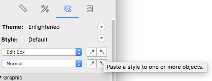

Now select FieldB and click the top right pipette button:image.png
Now again both fields have the same style.
