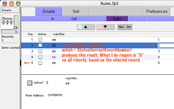

I know how to get the number of the currently selected record using a script. The question is, if there's also a way to figure out the number of the SELECTED record with just a calculation and NO script.

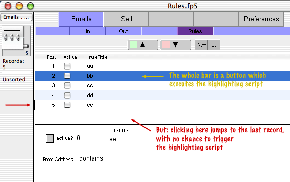

None of the Status(CurrentRecord...) functions provides this info as it seems. However if you take a look at the image below, you might understand why I'm asking.
Or does anybody know either how to prevent the empty space below the list from being clicked or how to make the empty space act like a button, so that it stills can trigger a script?

"if there's also a way to figure out the number of the SELECTED record with just a calculation and NO script."
You could use an unstored calculation which = Status(CurrentRecordNumber) - if you're going to do anything with the result.
But, if you just want to display it, just type @@ on the layout and this will display the current record number when in Browse Mode.
I'd bet long odds that RussBaker has hit the nail on the head -- make sure your calculation is unstored.

Unstored calculation doesn't seem to work:
@@ is nice, but IMO there's no way that FMP can read this info.

"Easier than you think... assuming that the blank row at the bottom allows the creation of new records and isn't just a blank related record."
Vaughan,
could it be that you are talking about a portal while I'm talking about list view?
