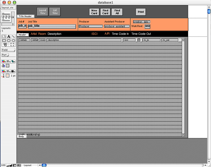

I work at a post production company that uses hand written notecards to write down time codes of work that are layed off to video tapes. I have been working to create a filemaker pro database system to eliminate these handwritten cards which are often lost through misuse.
Basically there are two layouts, card view and list view. I have it set up so that each card has editable information in it like NAME of CARD and CARD NUMBER which are transfered and displayed successfully in the list view. However, I have set up a portal in the card for each time-code entry. There could be several entries per card. I do not need this information displayed anywhere else but on each seperate card (assuming each card is a separate record).
Anyway, inside the portal are the fields date, artist_initials, room_number, description, time_code_in, and time_code_out. I have tried to look at several portal database templates but I cannot get it to work correctly. I set up a related file where the relationship is a calculation that results in 1. Please help. When I go into browser mode the portal fields are uneditable. Thanks.
