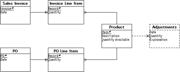

Below is an ER diagram showing a simple invoicing/purchasing system. Getting counts of products sold and products purchased is not too difficult, a simple calc field in the Product file can get these:
Quantity Available = Sum(PO Line Items::Quantity) - Sum(Invoice Line Items::Quantity) + Sum (Adjustments::Quantity)
Unfortunately, as the system grows, this calculation will get slower and slower.
There is another problem with this simple count: If items are lost, stolen, etc; the counts become incorrect. There needs to be a method for correcting inventory.
A good way handle both issues is to use a number field (instead of a calc) to hold the Quantity Available. Now the challenge is to make sure the Quantity Available gets updated regularly. This can be done every time an Invoice is finished and every time a PO is ordered by looping through the line items and updating the corresponding products' counts. There will also need to be some method to reverse these counts if an invoice or PO is cancelled.
In my ER diagram, I have an optional table for Adjustments. This could be used to do manual adjustments to the Quantity Available (instead of users just changing the number field). It lets you track changes a little better.
I'm sure there are other ways to handle this type of system, but that's what I've come up with. Let me know if it makes sense.

Just a quick word of warning regarding using a number field to hold the Qty. You will need to be carefull of record locking issues, two users trying to update the quantity of the same stock item simultaneously will give problems. I prefer the sum of transactions method, you can , if necessary "roll up" say last years transactions into a single transaction to reduce the number of records. The transactions method gives you a simple way of making stock adjustments for lost or damaged goods and gives a very good audit trail for checking levels.
