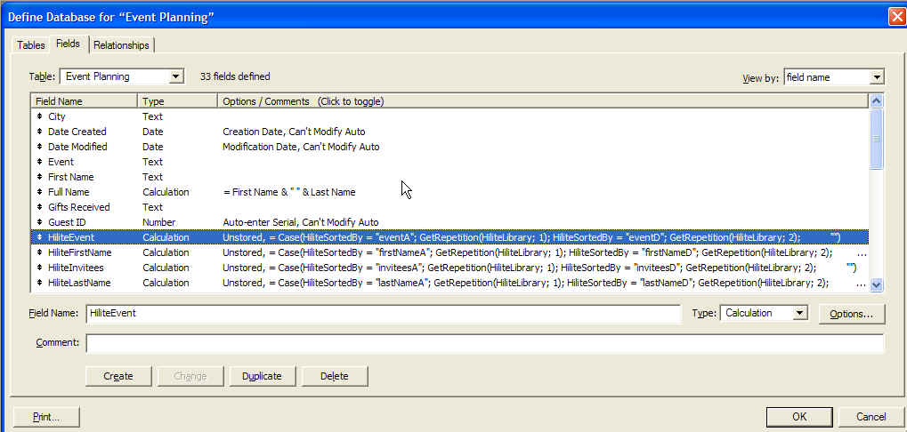

Here is what the field says. In case you are wondering I am an IT Trainer with experience of Access and have trained Filemaker at a basic level. I really like filemaker and am trying to build up my knowledge in order to use and train the package.
Case(HiliteSortedBy = "eventA"; GetRepetition(HiliteLibrary; 1);
HiliteSortedBy = "eventD"; GetRepetition(HiliteLibrary; 2);
In the field definition box it shows the field as "unstored ". I would love to know what that means too. I have attached a picture.
Thank you very much for your interest.
Shelley

Unstored versus stored: Unstored means don't store the results of a calculation, but recalculate when needed. For example when a unstored calc appears on a layout that the user is viewing, FM will calculate at that time.
One of the best uses for (global) repetition fields is to store graphic elements, and then pick them based on a calc criteria. Your example says use the color (or graphic) in Repetition 1 if HiliteSortedBy=EventA, if EventD use
Repetition 2. If Rep 1 has a graphic color of gray, and Rep 2 has green, you should be able to figure out what's going on. Display Hilite Library on a layout, right click on the Format Field and display all of the Repetitions. You'll see the graphics.

In the case of the Hilite, that you see a great deal of in some of FileMaker's templates, it's used to produce the little up and down triangles next to the field labels in List view layouts, to show which field the records are being sorted by, and the direction of the sort.
It took 3 scripts to do this in FileMaker 6 (it could have been done with 2, but 3 is less hassle), because you could only have 1 Sort step directly in a script. So, one ascending, one descending, and one to "toggle," doing ascending by default (if not sorted by that field), then toggle between the two Sorts once sorted by that field.
The setting of the Hilite field to little bits of text is just to keep track of what field the records are sorted by, and in which direction.
The triangles themselves are 2 objects in a global field, with 2 repetitions. Then each sortable field has its own calculated container field.
It's clever, but takes up a lot of room in the fields and scripts. In FileMaker 7 however, it can all be done with the one "toggle" script, as multiple Sort steps are allowed (and definable) within one script. Much neater. Actually all the various "field" scripts could be condensed to just 1 script, as only 1 field can be shown as sorted at any one time.
